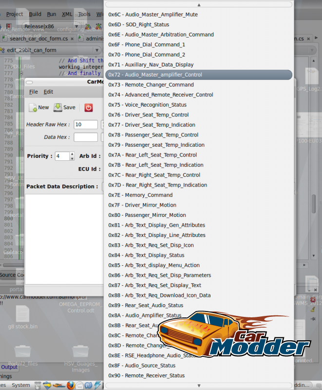

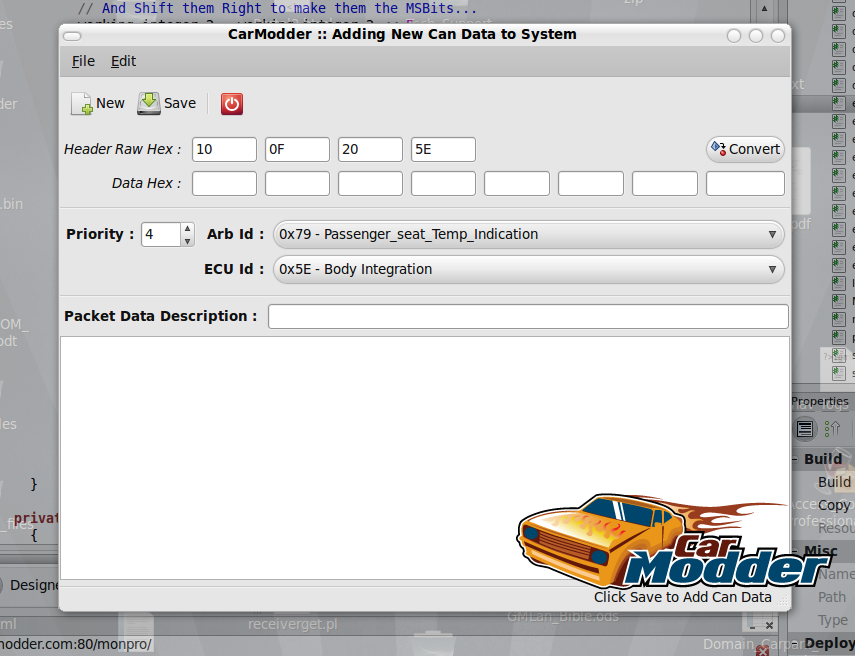

14830
And......
14831
I will make the software open source for anyone that wants to play...
(Just need to fix the ArbIDs that I have, as most of them I have entered incorrectly)...
I will probably release this early, and then try and integrate with the Can Sniffer software..
(I want the sniffer software to automatically map the ArbIDs and ECUs, as well as highlight anything that is new, or not known)...
There is around a couple of more days worth of work before this is ready...
Once its complete I will release it...
