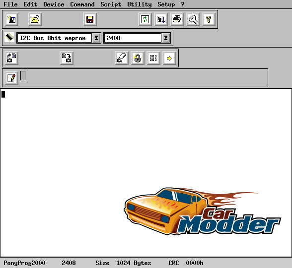

1) Open the PonyProg Program
(On Ubuntu, this is located in Applications, Programming, PonyProg2000)
2) The following Screen will be displayed
12838

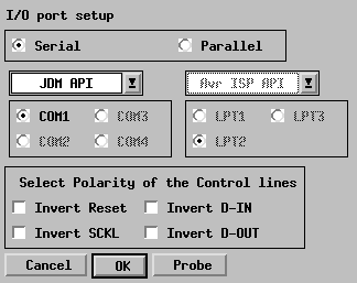

5) The following screen will now be displayed.
12837
This screen allows you to configure your EEPROM Programmer
The above settings work for my Serial Port 24Cxx, 93Cxx and 25xxx EEPROM Programmer. (http://www.nbglin.com/eeprom.htm)
6) Press the PROBE button. This should probe the EEPROM programmer and automatically configure the settings for your programmer.
7) If the Probe is successful, Press the [OK] button to save the EEPROM configuration.
