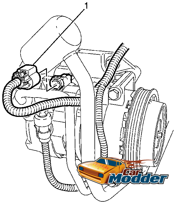

•Disconnect the compressor electrical connector (1).

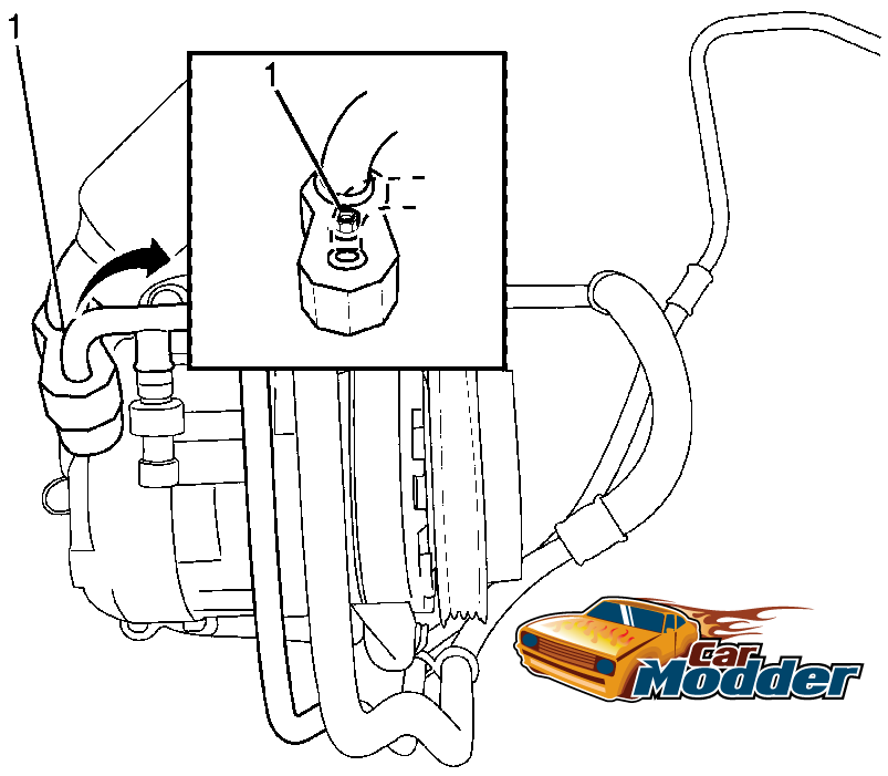

•Remove the suction/discharge pipes pad to compressor retaining bolt (1).
•Disconnect the suction/discharge pipes (1) from the compressor (3).
14580
14581
Important: The sealing washers (2) are a single use item and must be discarded after use.
•Remove the sealing washers (2). Refer to Air Conditioning System Seal Replacement.
Discard the sealing washers
Important: Cover any opening of the A/C system with a suitable cap or tape immediately, to prevent absorption of moisture from the atmosphere.
•Cap or plug the suction/discharge pipes (1) and the ports on the compressor (3).

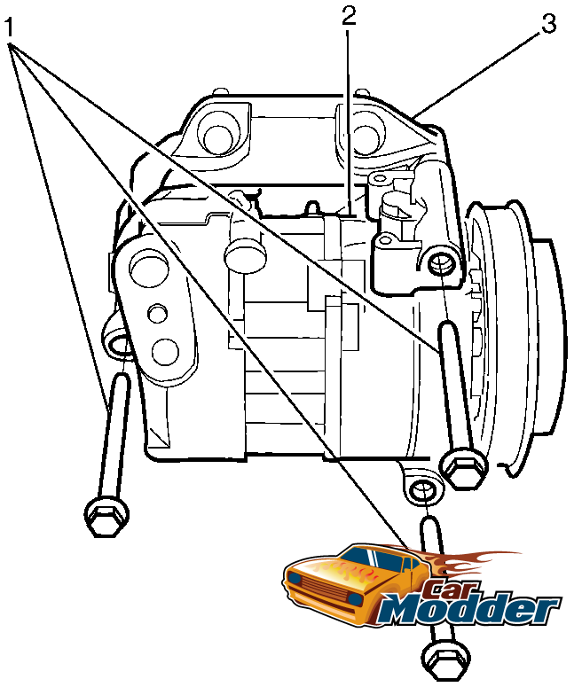

•Remove the compressor to compressor bracket retaining bolts (1).
14582
Important: Remove the compressor (2) from the compressor mounting bracket (3) by sliding forwards and than tilting upwards out of the engine compartment.
•Remove the compressor (2) from the compressor bracket (3).

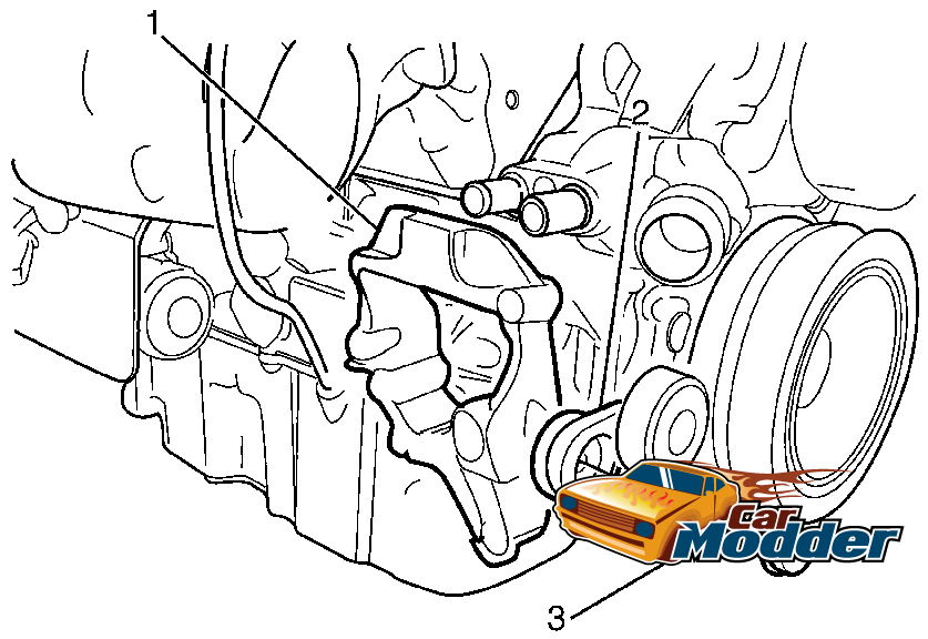

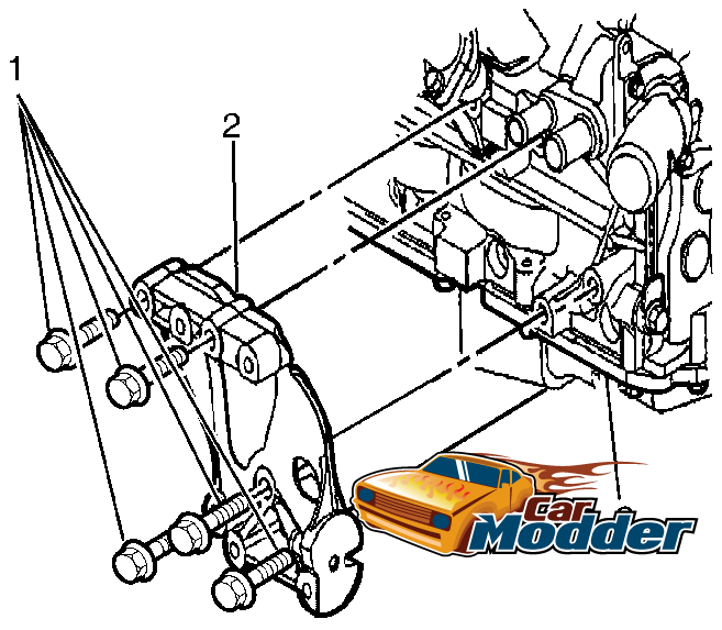

•Remove the compressor mounting bracket to cylinder block retaining bolts (1).
•Remove the compressor bracket (2) from the cylinder block (3).
