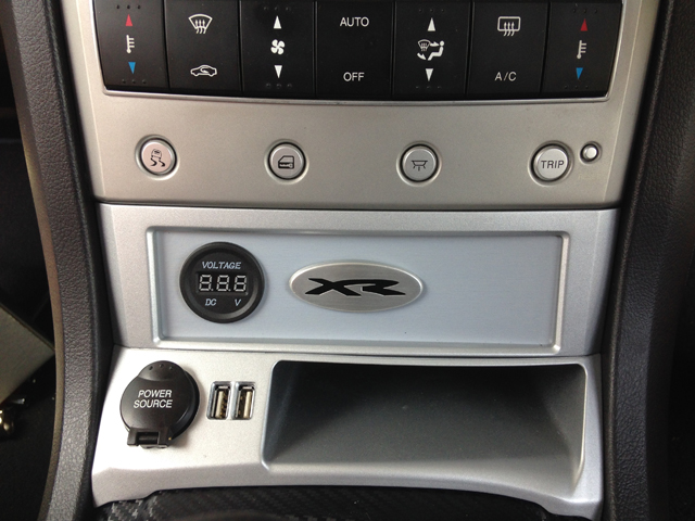

Postby TazzI » Wed Jan 27, 2016 8:12 pm
The old man got creative today and fitted this crafty piece of work!
Filled in the top din, added in a volts gauge, a little fancy badge and the right side will have a push start button similar to that of the FPV style.
Also converted the standard AUX to a bluetooth system which auto connects on startup... so bluetooth music and handsfree now working!
We are a couple shades off of the ICC colour, but trial and error will prevail. ;)

Postby TazzI » Thu Jan 28, 2016 11:50 am
All the wiring, converter, and little project box all fits nicely behind the insert. Without the insert.. not quite sure where this would all fit nicely and out of sight.

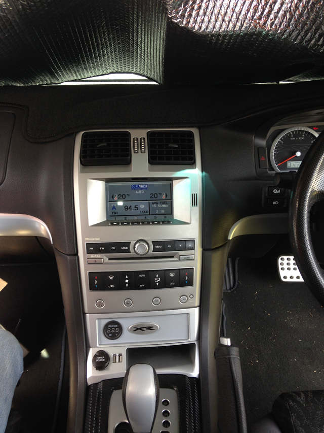

Postby TazzI » Wed Feb 03, 2016 10:22 pm
All fitted and running..
(yes... battery is low... Iv ran it flat multiple times today :lol: Also sun was just coming down, incase anyones wondering about the bright light in the screen!)
Annnnnnd... a quick video of flicking between park and drive! ;)
