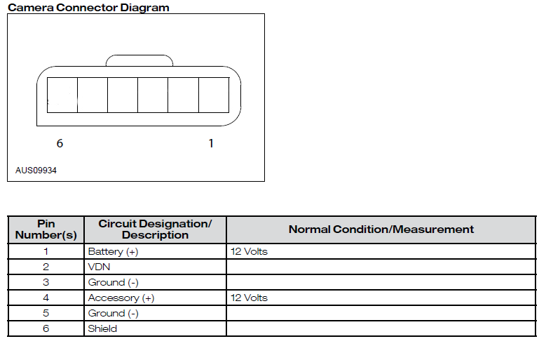

Postby TazzI » Wed Jun 14, 2017 10:22 am
Camera wiring. No CANbus there so thats a good thing :)

JeffDav wrote:With a hacked sync install and some wiring changes i have most things working, have not yet figured out the reverse camera, i do have it enabled and have a fault code for the camera not been detected therefore i believe the difference must be in the camera, I assume it talks on the can-bus for the predictive grid lines and zoom? whilst video is still analogue, going to get hold of a reverse camera and try this out, i have seen you can get boxes to do this so i assume these just simulate these commands and provide an analogue connection?
Right, for the reverse camera. When you select reverse, does anything pop up on screen? As in even a blank display? Just like the earlier FG ICCs?
I know some devices can be smart enough to detect an composite signal (My TV for instance) and knows when theres no signal or anything connected.
What does the fault code say? Does it come up on screen when you go into reverse?

Best yet i can make the unit work with a $35 reverse camera no need for genuine ford camera / special boxes.
my unit is definitely reverse cam enabled but doesn't give me a reverse screen when its selected. There is a pcb in the shifter assembly that reports the current gear to the instrument cluster, i believe this is different in the fgx and it is responsible for reporting the reverse gear to the FDIM hence why i cant make it give me the reverse screen with any mk1 / fgx module combo. i will get one of these and have a tinker.
i believe the fault code was something along the lines of reverse camera module not detected. but is gone now with a camera connected.
