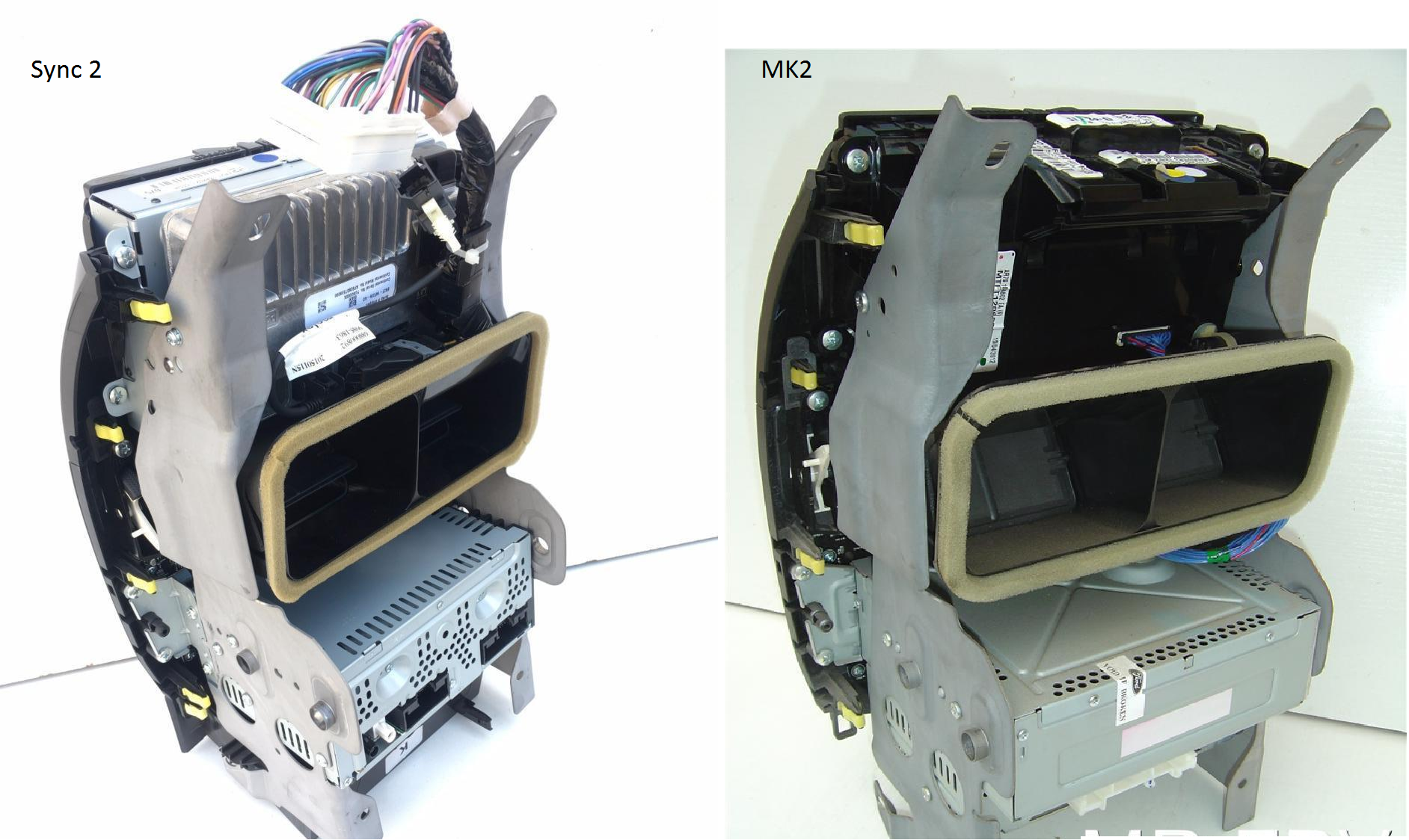

I think it might be more a challenge of making it fit nicely due to the cables at the back for the ACM.
Im hoping the plugs for the sync2 on the back will line up with the factory gap/spacing where the mk1/2 ACM plug is. Would probably need to be push that plug of its mounting to make room for the patch loom also.
Annoying part would be sourcing the female socket thats normally fitted to the mk1/2 ACM's to make a plug and play harness for the sync2.
Quick google, here is rear views of Sync2 and Mk2.
