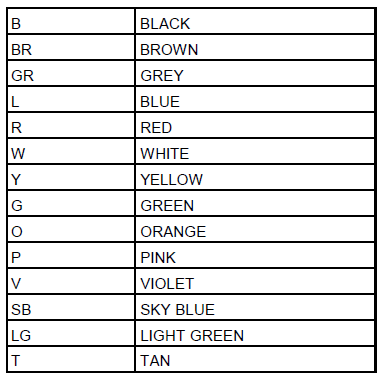

Robertau wrote:isnt it black for ground, black yellow for acc? thats how i have mine wired up and working.
blue in the SCH's is L im sure
Rob
OH! I was too far zoomed out. Mistook the "B" as being Blue and not Black. :lol:
Ill update my other posts now

Postby Robertau » Sat Mar 12, 2016 7:40 pm
Rob
easy to do i done it heaps reading the sch's lol
Rob
