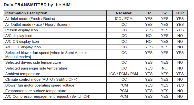

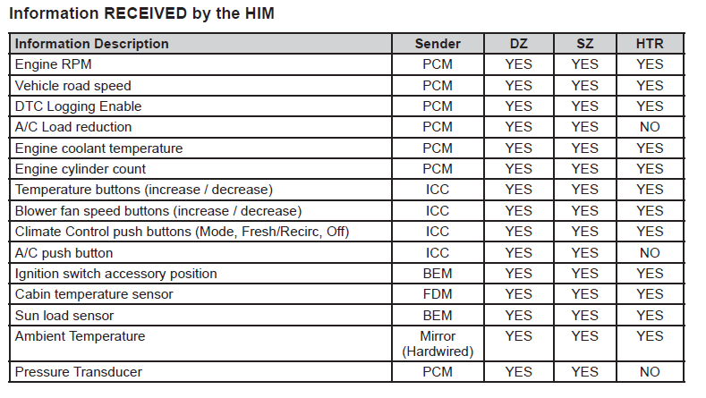

Postby TazzI » Fri May 19, 2017 12:43 am
Nice list of the features received and transmitted by the HIM. Least that makes a good checklist to ensure all bits and bobs are found.
