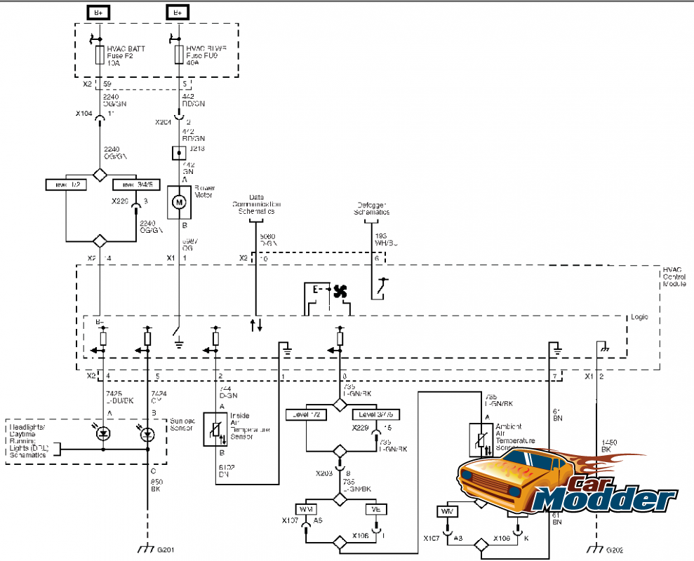

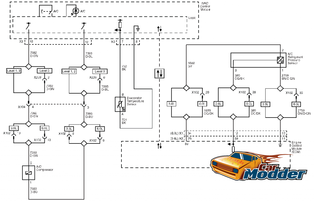

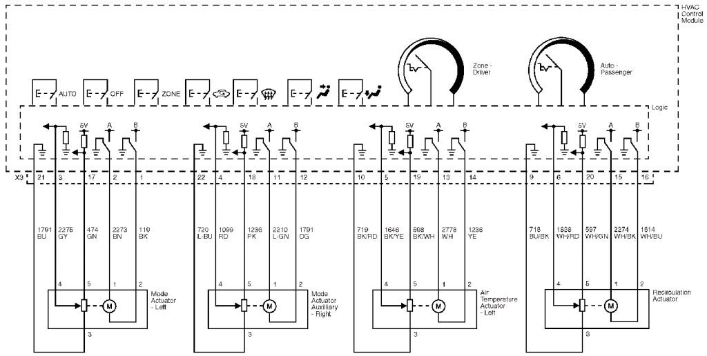

Automatic (Dual and Triple Zone) Climate Control Wiring Diagrams
Airconditioning Compressor Control
14708
Temperature and Air Direction Control
14706
Automatic Climate Control Input Sensors
14707

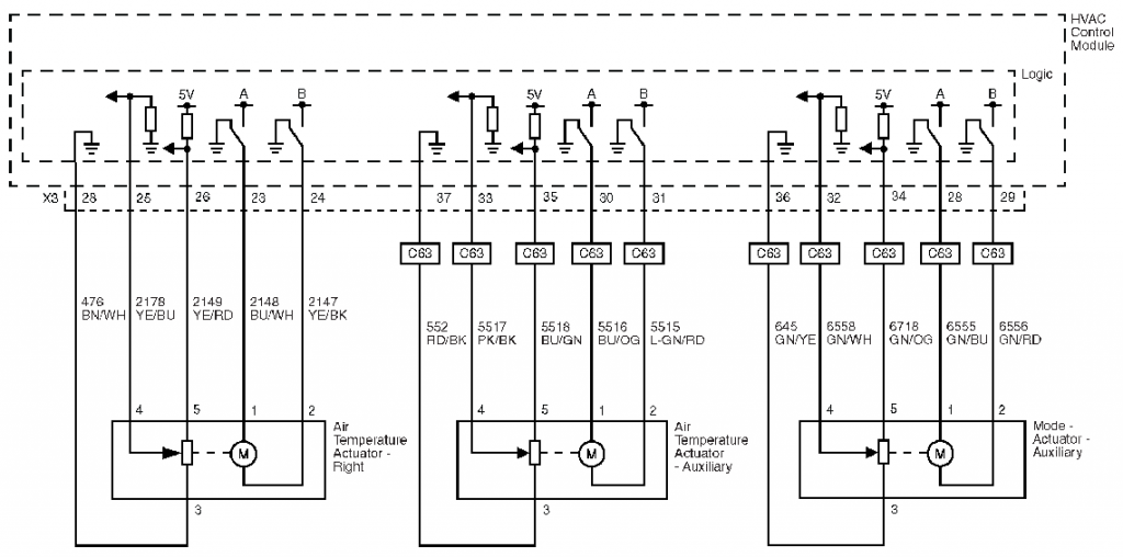

Dual Zone Control
14705

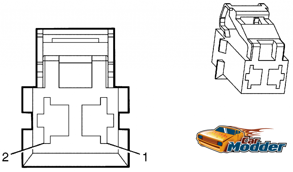

HVAC HCE Module X1 Connector
14713
Pin 1 - Orange - HVAC Blower Motor Control Wire
Pin 2 - Black    - Ground

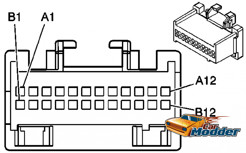

HVAC HCE Module X2 Connector
WARNING : This information has been obtained from the factory workshop manual,
however it appears that this connector is completely different for Single Zone, and Dual one Climate Control
HCEs.....
As such, the information for this connector is not reliable !!!!!
14714
Pin A1 - Light Blue                         - Air Temperature Door Position Sensor
Pin A2  - Yellow / Black Stripe         - Mode Door Position Signal
Pin A3  - Brown                            - Recirculation Door Position Signal
Pin A4  - Gray                              - Rear Mode Door Position Signal
Pin A5  -                                     - Not Used
Pin A6  - Light Blue                       - Rear Passenger Air Temperature Door Control
Pin A7  - Light Green / White Stripe  - Rear Mode Door Control A
Pin A8  - Yellow                            - Air Temperature Door Contorl Low Reference
Pin A9  - Grey / Black Stripe            - Passenger Air Temperature Motor Control
Pin A10 - Yellow                            - Mode Door Control B
Pin A11 - Grey                              - After Boil Coolant Pump Relay Control
Pin A12 - Purple                            - Recirculation Door Control A
Pin B1   -  Dark Blue                       - Passenger Air Temperature Door Position Signal
Pin B2   -                                     - Not Used
Pin B3   -  Dark Green                     - Rear Passenger Air Temperature Door Signal
Pin B4   -  Purple                           - Rear Mode Signal Switch
Pin B5   -  Light Blue                      - Rear Temperature Switch Signal
Pin B6   -  Brown                           - Rear Passenger Air Temperature Door Control B
Pin B7   -  Light Green / Black Stripe - Rear Mode Door Control B
Pin B8   -  Dark Blue                       - Air Temperature Dor Control
Pin B9   -  White / Black Stripe         - Passenger Air Temperature Door Control
Pin B10  -  Tan                              - Mode Door Control A
Pin B11  -                                     - Not Used
Pin B12  -  Dark Green                     - Recirculation Door Control B

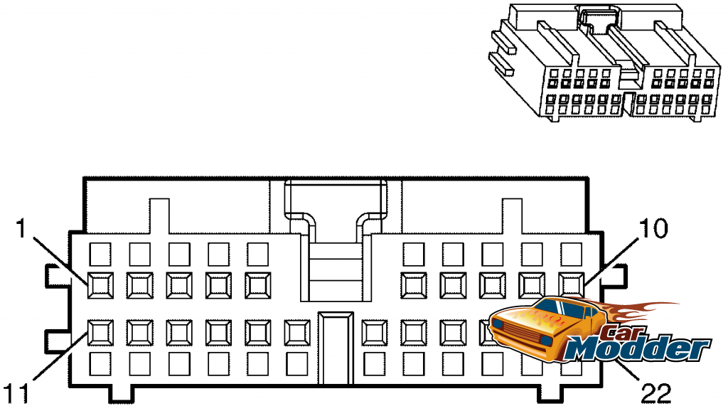

HVAC HCE Module X3 Connector
14715
Pin 1   -  Black                               - Mode Actuator 1 Control
Pin 2   -  Brown                              - Mode Actuator 1 Power
Pin 3   -  Grey                                - Mode Actuator 1 Feedback
Pin 4   -  Red                                 - Mode Actuator 2 Feedback
Pin 5   -  Black / Yellow Stripe           - Air Mix Actuator Feedback
Pin 6   -  Grey / Red Strip                 - Recirculation Actuator Feedback
Pin 7   -  Black                                - Evaporator Temperature Sensor Signal
Pin 8   -  Black                                - Evaporator Temperature Sensor Low Reference
Pin 9   -  Dark Blue / Black                - Low Reference
Pin 10  -  Black / Red                       - Low Reference
Pin 11  -  Light Green                       - Mode Actuator 2 Power
Pin 12  -  Orange                            - Mode Actuator 2 Control
Pin 13  -  White                              - Air Mix Actuator Power
Pin 14  -  Yellow                             - Air Mix Actuator Control
Pin 15  -  White / Black Stripe           - Recirculation Actuator Power
Pin 16  -  White / Blue Stripe            - Recirculation Actuator Control
Pin 17  -  Dark Green                       - 5V Reference
Pin 18  -  Pink                                - 5V Reference
Pin 19  -  Black / White                    - 5V Reference
Pin 20  -  White / Green                   - 5V Reference
Pin 21  -  Dark Blue                         - Low Reference
Pin 22  -  Light Blue                        - Low Reference

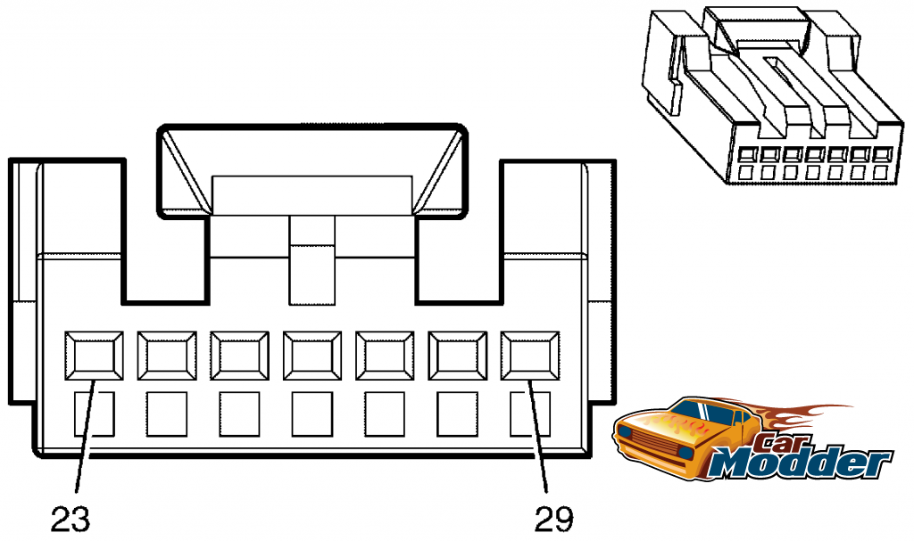

HVAC HCE Module X4 Connector
14716
Pin 23   - Dark Blue / White Stripe     - Dual Zone Air Mix Actuator Power
Pin 24   - Yellow / Black Stripe          - Dual Zone Air Mix Actuator Control
Pin 25   - Yellow / Blue Stripe           - Dual Zone Air Mix Actuator Feedback
Pin 26   - Yellow / Red Stripe            - 5V Reference
Pin 27   -                                      - Not Used
Pin 28   - Brown / White Stripe         - Low Reference
Pin 29   -                                      - Not Used

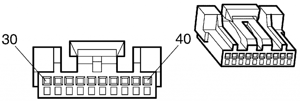

HVAC HCE Module X5 Connector
Warning : The pins for this connector are not available on single and dual zone HVAC Models.
14717
Pin 30   - Dark Green / Blue Stripe      - Mode Actuator Rear Power
Pin 31   - Dark Green / Red Stripe       - Mode Actuator Rear Control
Pin 32   - Dark Blue / Orange Stripe    - Tri Zone Air Mix Actuator Control
Pin 33   - Light Green / Red Stripe      - Tri Zone AIr Mix Actuator Power
Pin 34   - Light Green / White Stripe   - Mode Actuator Rear Feedback
Pin 35   - Pink  / Black Stripe             - Tri Zone Air Mix Actuator Feedback
Pin 36   - Dark Green / Orange Stripe  - 5V Reference
Pin 37   - Dakr Blue / Green Stripe      - 5V Reference
Pin 38   - Dark Green / Yellow Stripe   - Low Reference
Pin 39   - Red / Black Stripe              - Low Reference

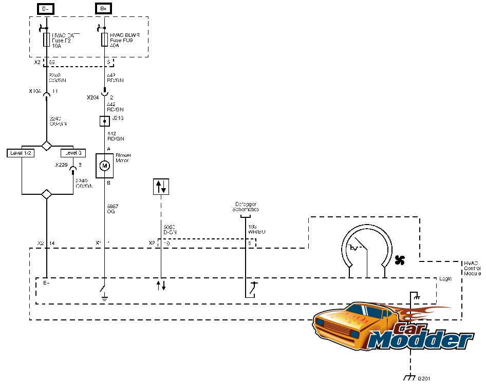

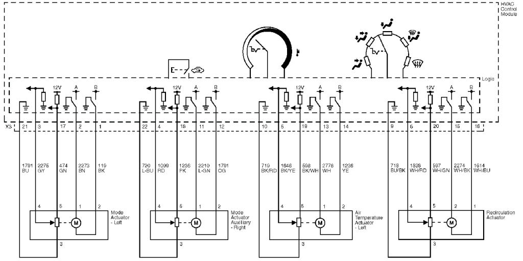

Manual HVAC Wiring Diagrams
Air Conditioning Compressor Control
14718
14719
14720
