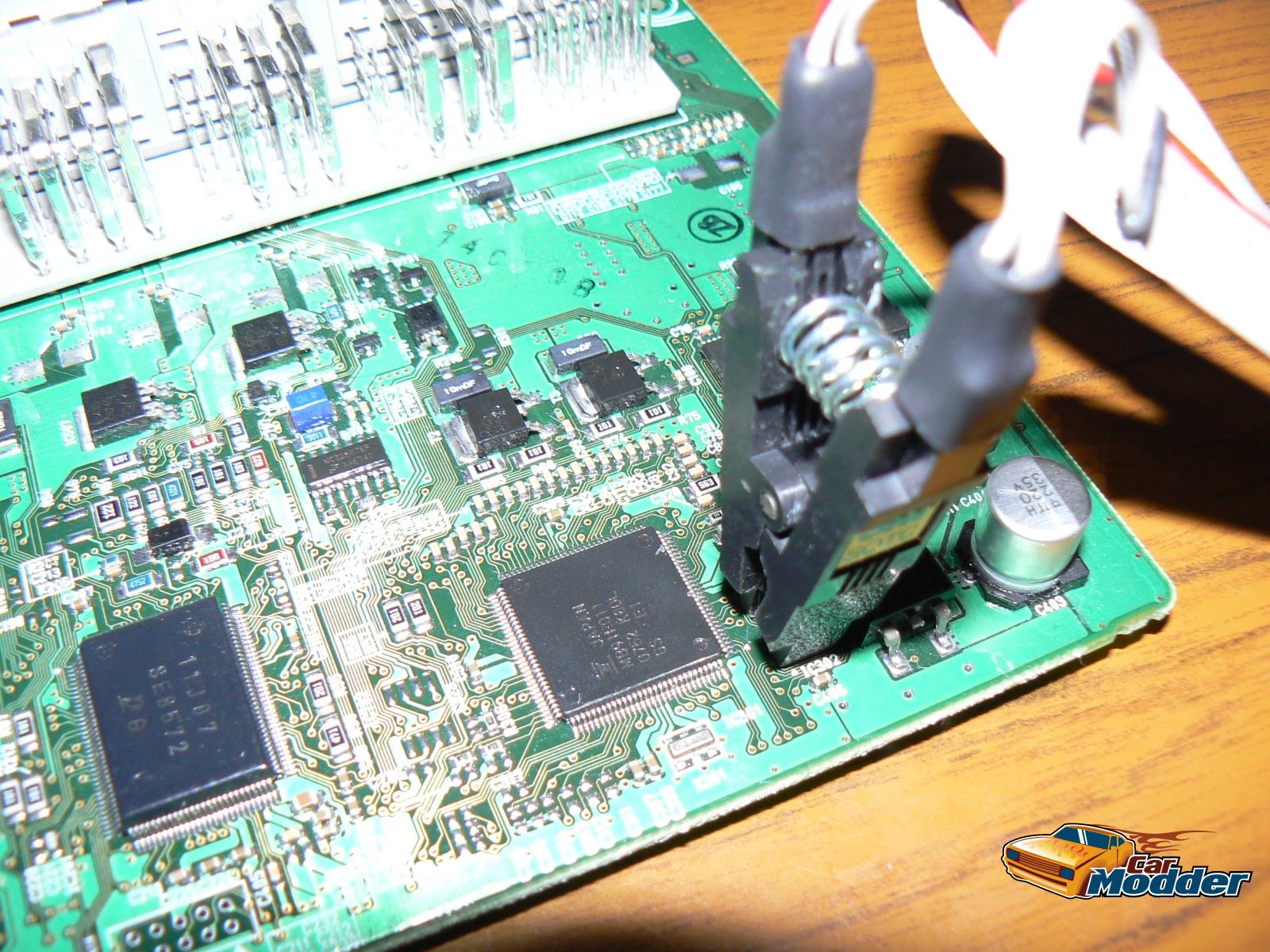

Postby antwon » Tue Jun 06, 2017 7:05 pm
ZerOne wrote:The VIN Number is located at EEPROM Locations
0x01E -> 0x02E (Full 17 Digit VIN Number)
and
0x0F6 -> 0x106 (Full 17 Digit VIN Number)
I can also confirm that I am able to read from, and write to the EEPROM using the KeeProg EEPROM programmer using the above settings,
without having to remove the EEPROM from the board. (However I needed to remove the resin from the chip to make a good electrical contact).
(Will try the GQ-4X EEPROM programmer next, to see if it can read and write whilst on the board)...
For anyone that wants to play at home, the EEPROM location is here.
15574 15573
Hi great info top job Ive got a question I'm trying to find the location for the bcm sec code does anyone have an idea weee it may be

Postby jezzab » Thu Jun 08, 2017 8:44 am
There is no security code in the VE BCM
