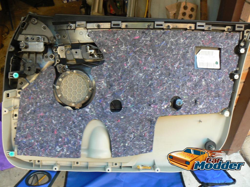

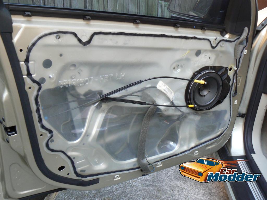

Door Trim Removal
14555
Door Trim Removed
14556

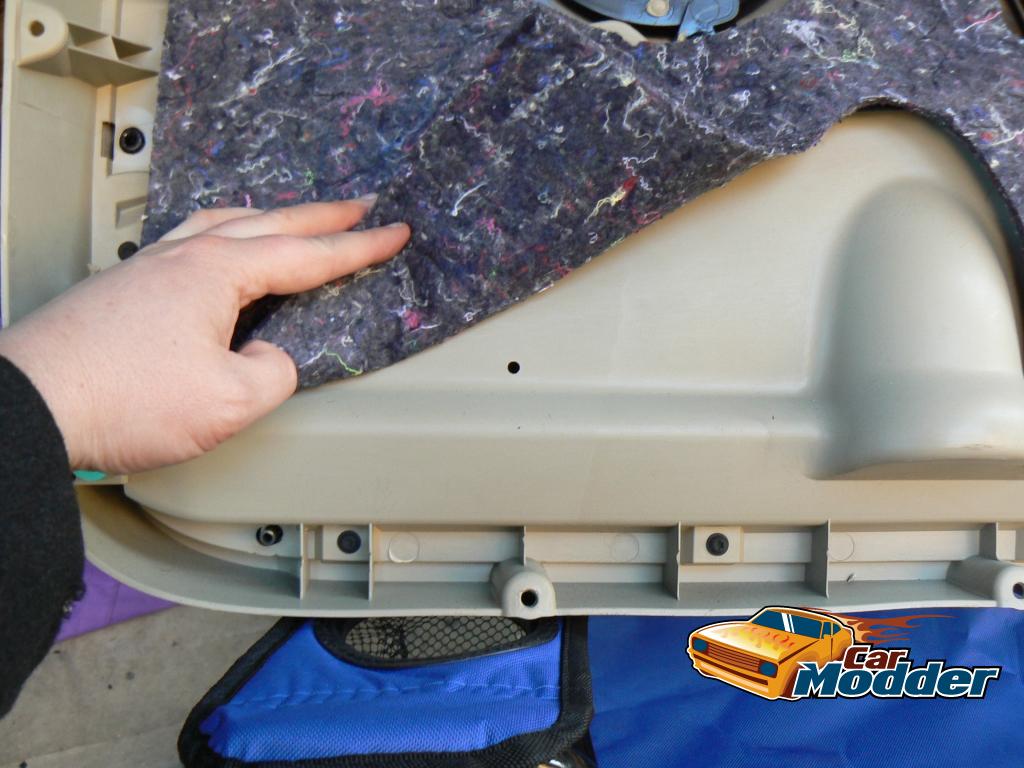

Before drilling hole around the Door release handle
14552
After Drilling hole around door release handle
14553

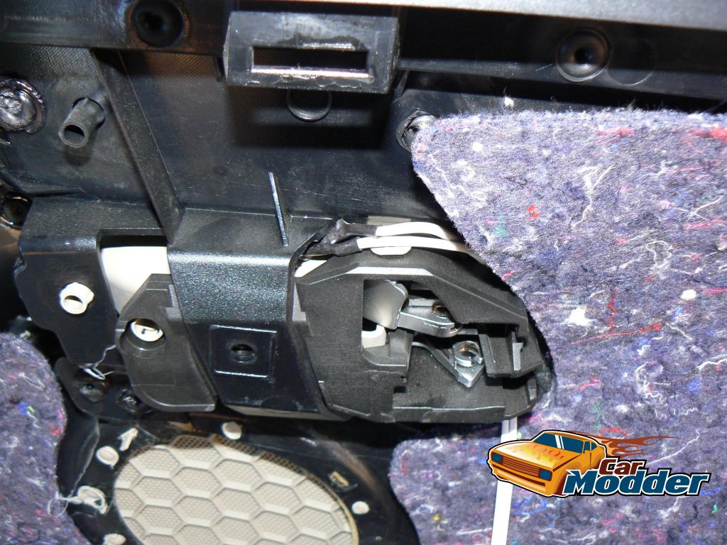

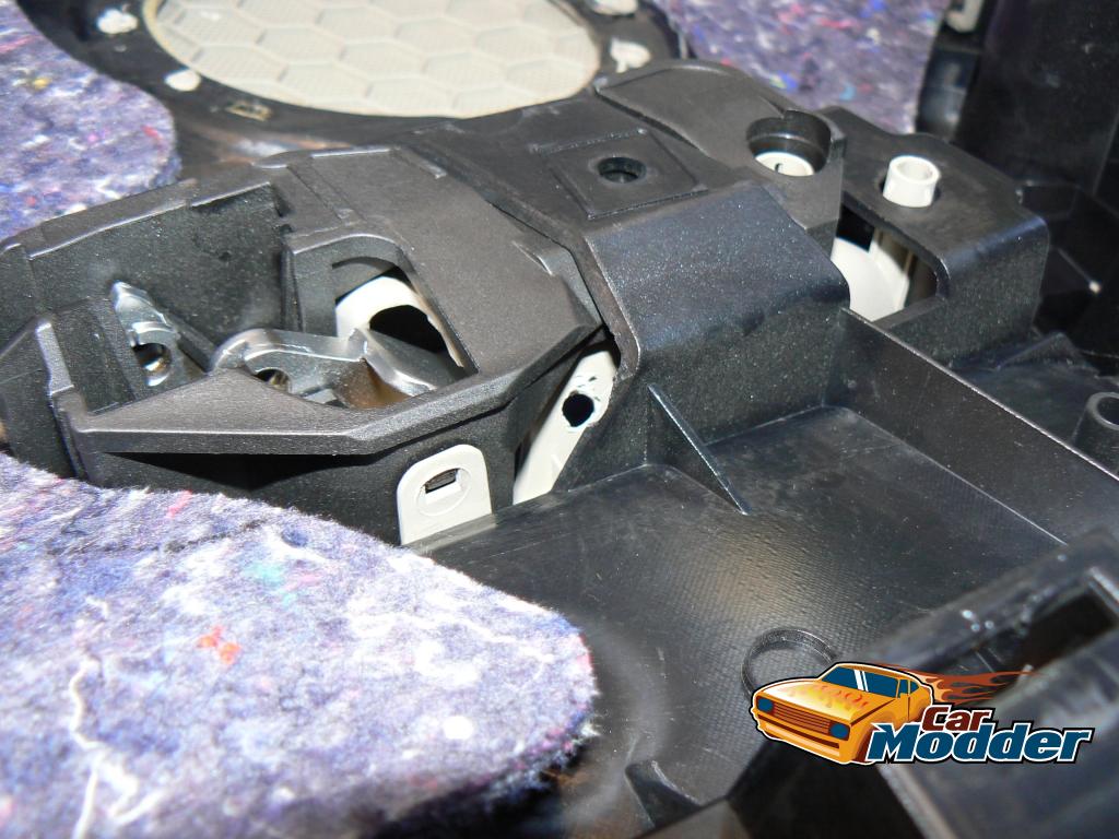

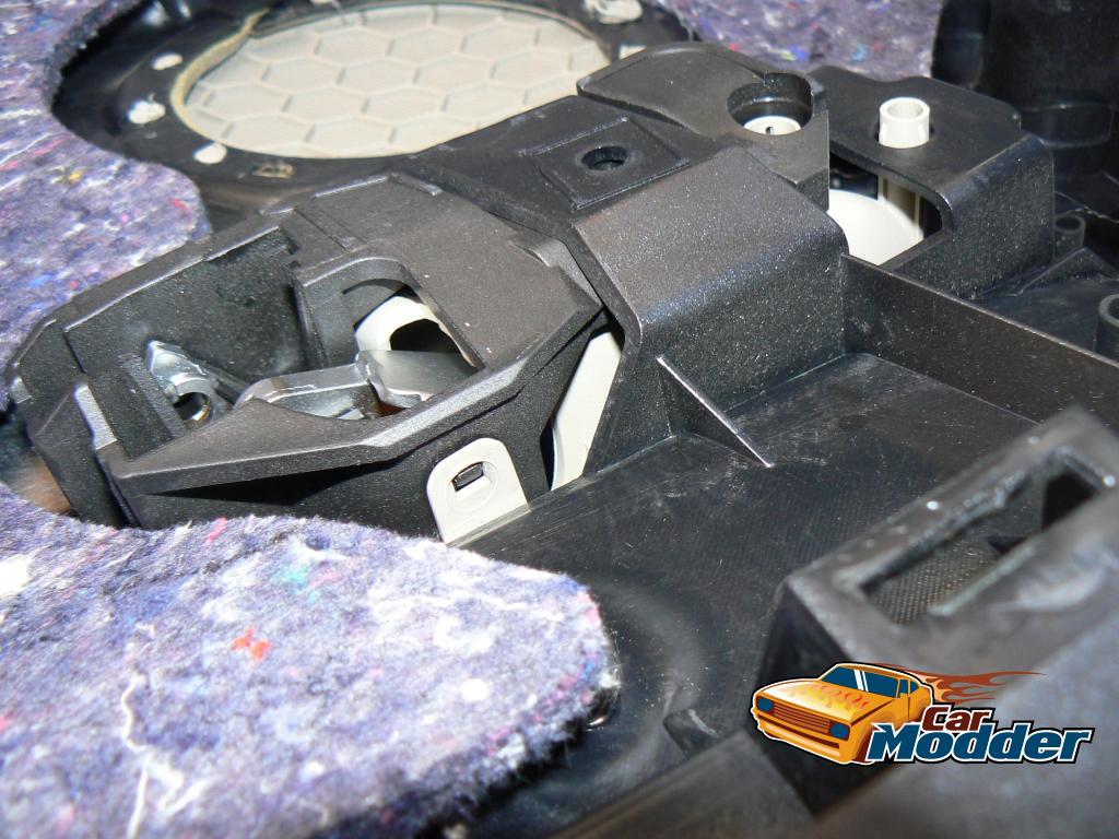

Fitting LED to door release handle trim
14554

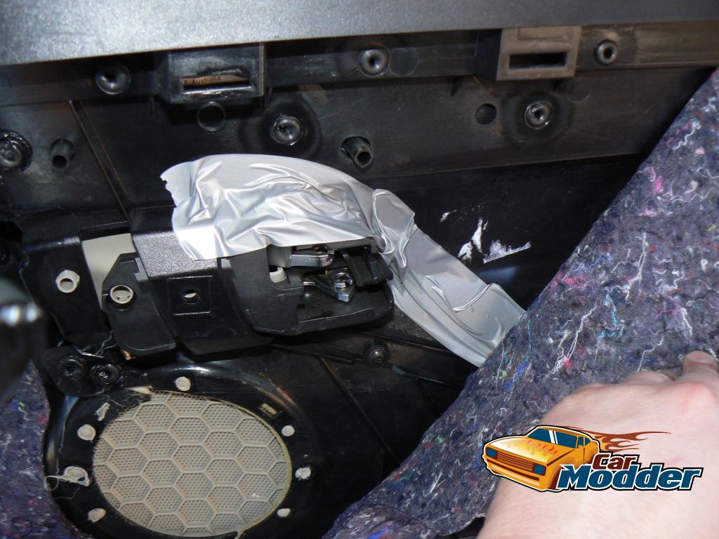

Duct Taping up the wiring around the door release handle
14568

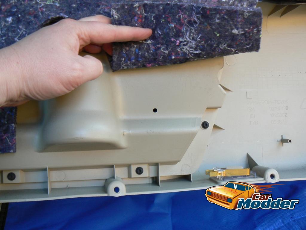

Drilling hole for door pocket LED fitment
14557
More Drilling holes for door pocket LED fitment
14558

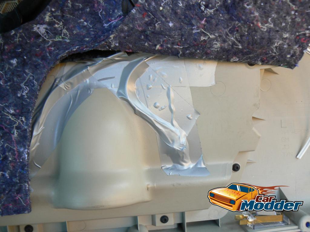

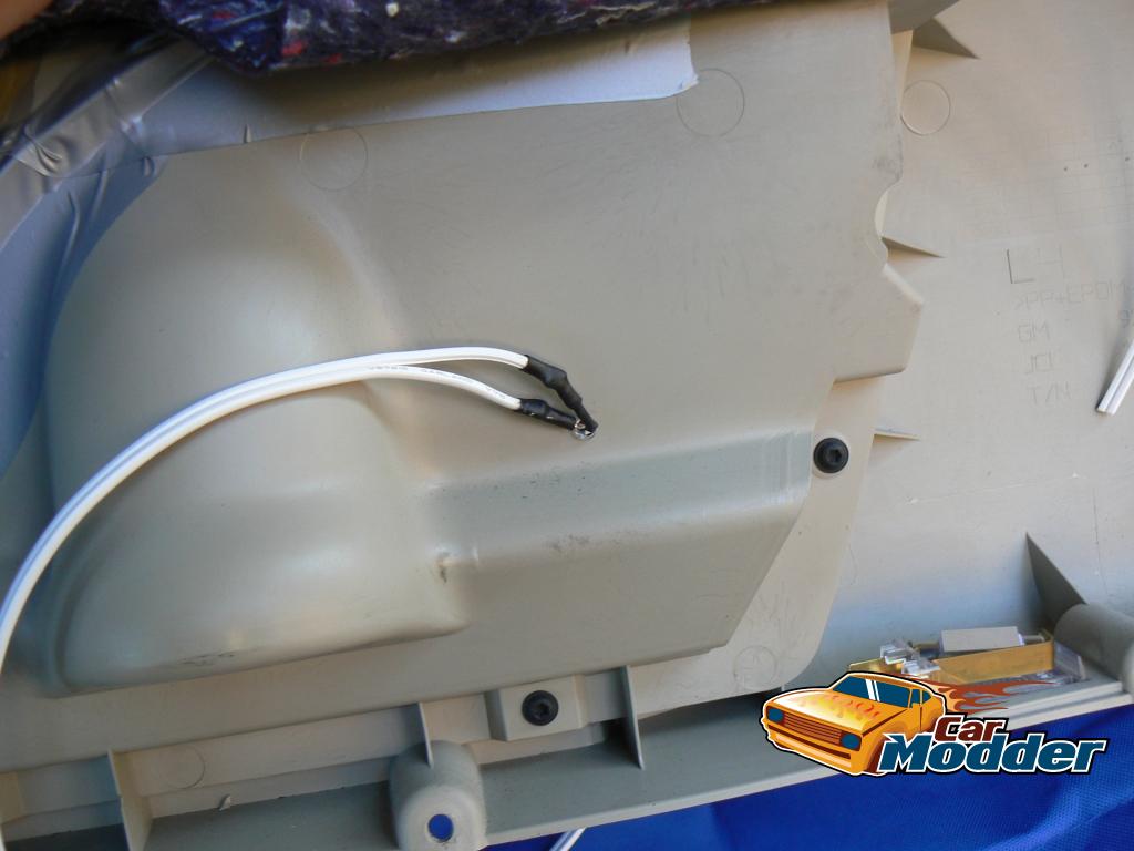

Fitting the LED to the door pocket hole
14560

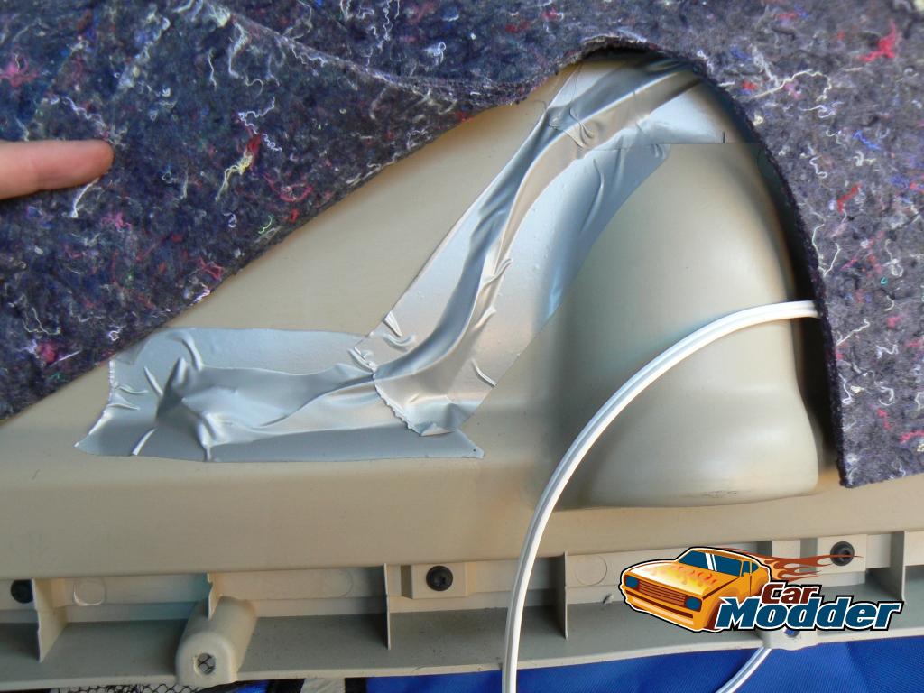

Duct tape over door pocket LED fitment
14559

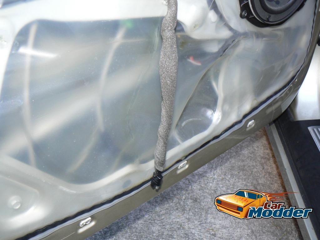

Duct Tape over the new wiring
14561

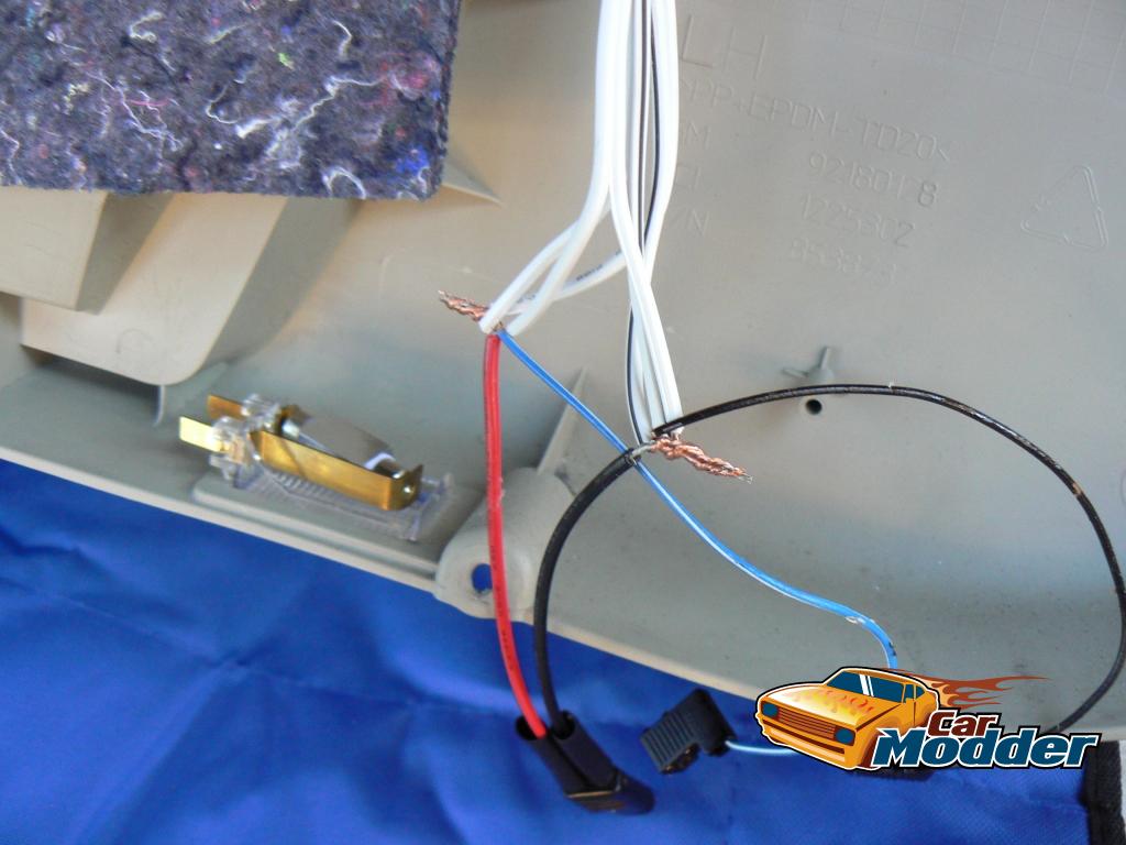

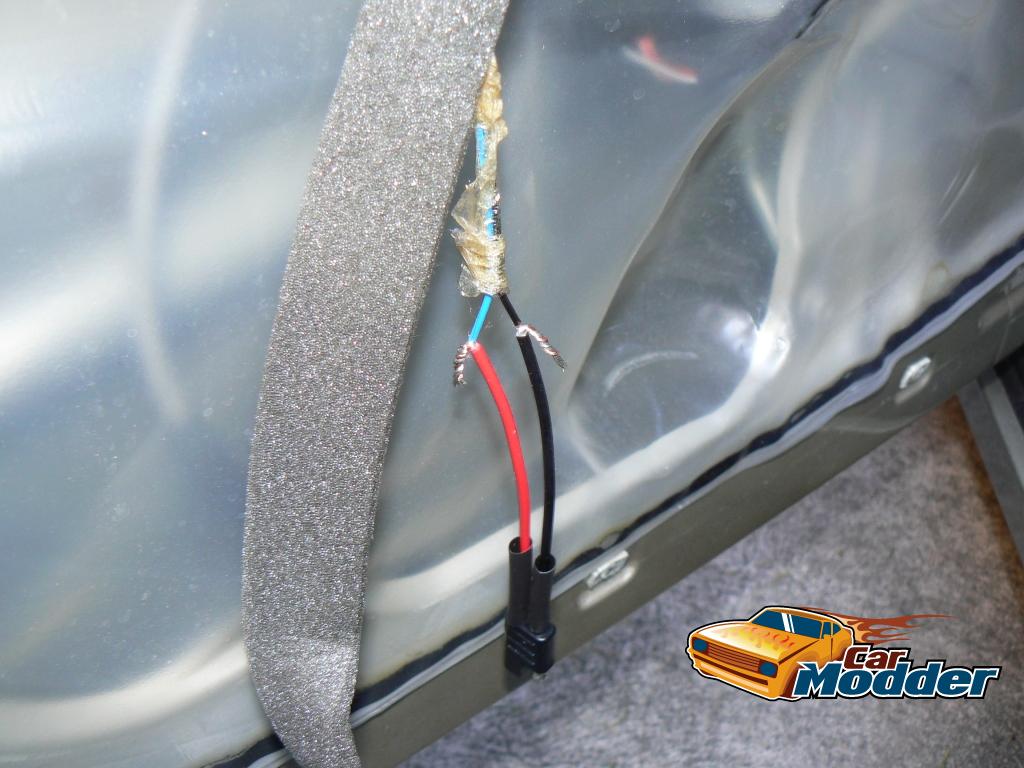

Original Door Wiring
14567

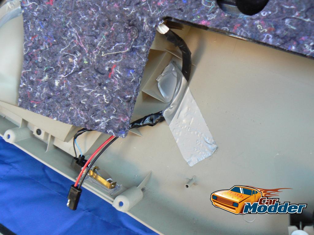

Modifying the Door Wiring
14565
Door Trim Wiring
14564
Door Trim Wiring Complete
14566

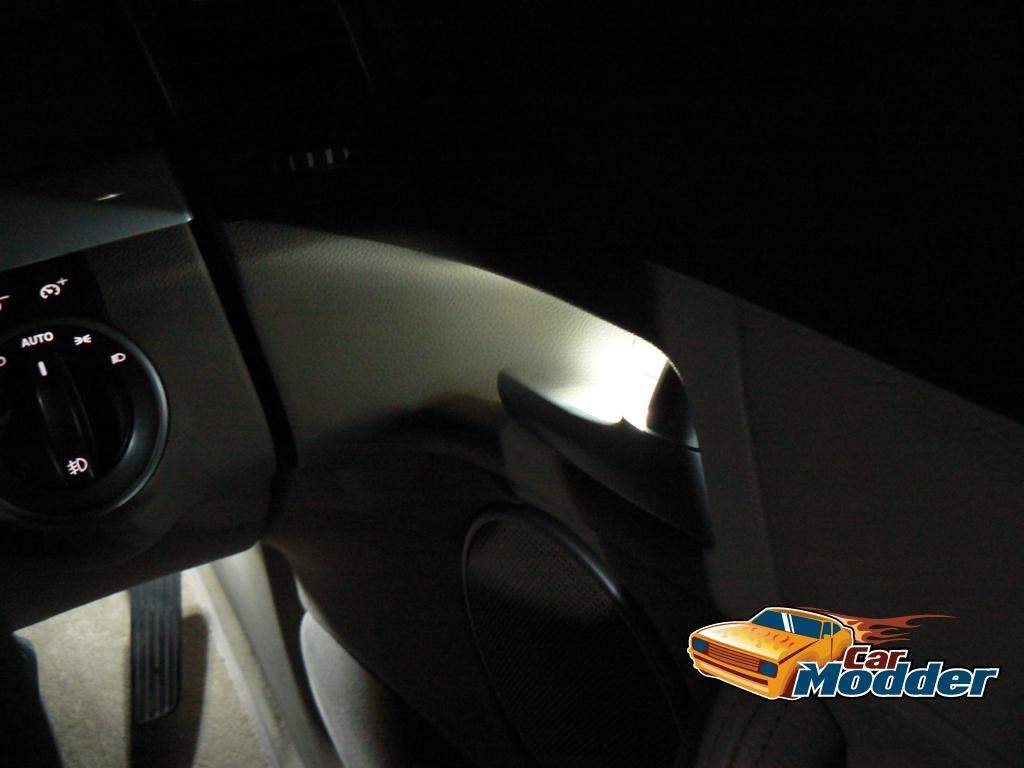

Here is the Passenger Side front door Handle
14818
You can see the map pockets don't light up very well. I used two LEDs, but I think around 4 would be better.
Here is a picture of the Drivers side door handle.
14817
I couldn't take any good shots, as its raining pretty heavily outside.
(Looks like Sydney will be in for some more localised flooding... Yay...)
The rear map pockets light up much better than the front ones (They use 2 Leds, but the pockets are much smaller)...
I am working on the Doco as we speak, which will include detailed information on how to get the door trims off.
Easy when you have done it a couple of times, damm near impossible the first time you try it though :(
