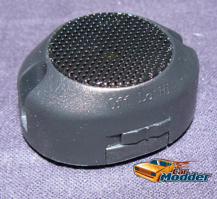

Parts used for Parking Assist Option 3 (Dealer Fit and HSVi Options)
Park Assist Speaker (Mounted on the passenger side of the boot, near the parcel tray).

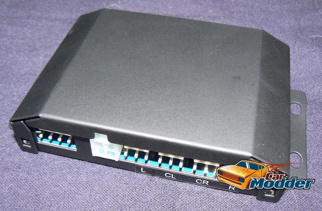

Park Assist Module (Mounted on the Passenger side of the boot, between the battery and rear parcel tray).
14601

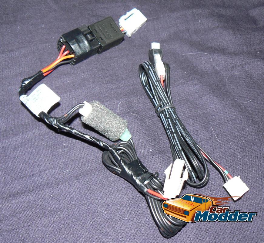

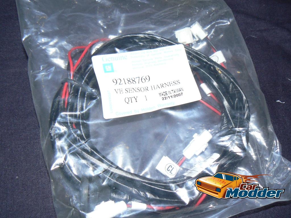

Park Assist VE Wiring Loom for Sensors
14600
Park Assist VE Wiring Loom for Reverse Lights, Trailer Plug and Power
14598

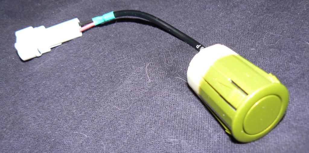

Park Assist Sensor (Crunch Colour Shown)
14602

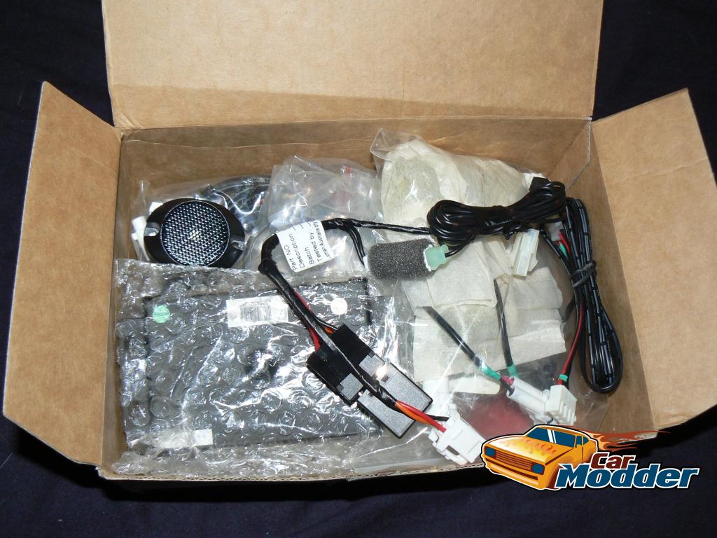

Park Assist Kit, as sold by Holden Parts
14599
