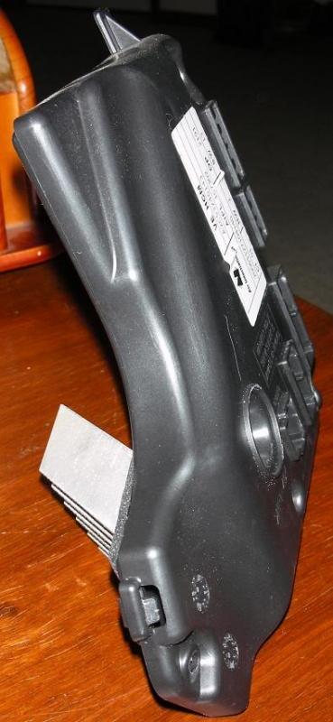

Postby ZerOne » Tue Feb 07, 2012 1:56 pm
Here is an image of the HVAC HCM Module....
It appears that this is the module that can be programmed to support Single, Dual, Triple or Blower Only.
14703

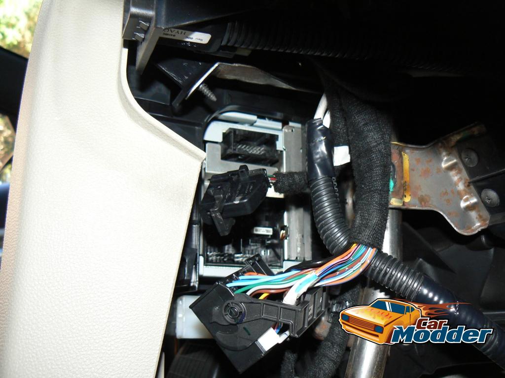

I will have a look at the Workshop manual tonight, and try and work out what differences there are in terms of wiring, for the Cabin, Exterior temp sensors. (I know the Calais Interior Temp sniffer motor pipe is just to the right of the radio unit, up near the instrument cluster...
Will try and get some pictures up soon...
Ohh, and this module is located to the left of the HVAC blower fan, which is just behind the glove compartment..
Postby ZerOne » Tue Feb 07, 2012 3:08 pm
Looking at the top of this image, you can see the HVAC Cabin Air temp sensor hose.
14656
I dont know much about how it works on the VE, but with older Ford Falcon models, it was connected to the engine vacuum, which forced a steady stream of air over a thermistor to obtain the cabin temperature.
Also, on the Ford Falcon models, the sunload sensor for the HVAC system was located where the current ambient light sensor is on the Dash of the VE models. Ford at a later stage used this sunload sensor to automatically turn On/Off the headlights during dusk periods....
The Sunload sensor determined if the windscreen demist mode should be used to cool the glass, if there was an excessive amount of sunlight.
I cannot confirm this is the same with VE models, but hopefully this is the case as well.
