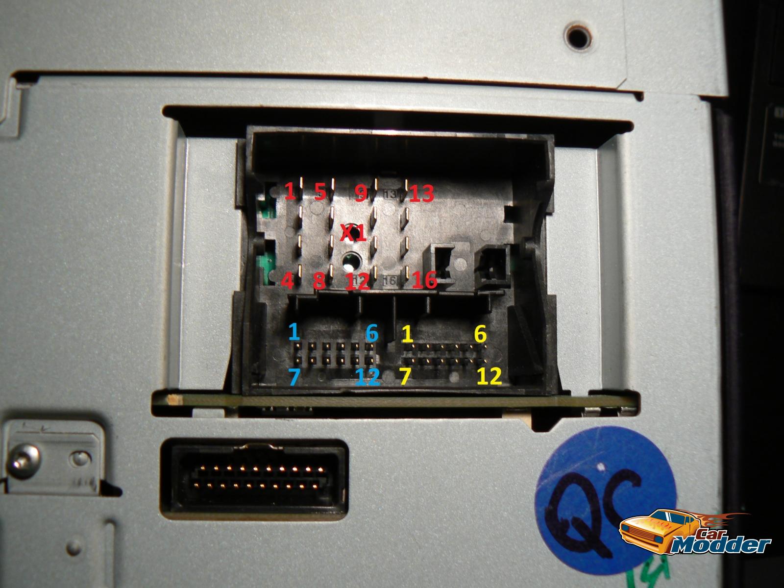

Also to answer your rear Aux question,
15762
X3 Connector Pin 9 is the RSE Right Channel Input (Rear DVD Player)
X3 Connector Pin 3 is the RSE Left Channel Input (Rear DVD Player)
X3 Connector Pin 4 is the Ground for the above inputs.
The X3 Connector is the bottom LHS Connector (With the blue numbers)
Oh, and to get these inputs to work you will need to enable the RSE Option on your IQ Unit (Via Tech2)
This will also allow you to use the Video Input for RSE
I hope this helps
