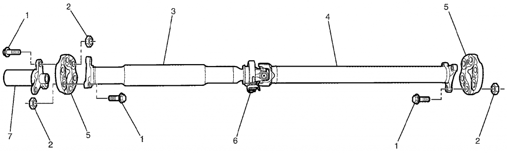

14723
(1) Rubber Coupling to Propeller Shaft Retaining Bolt
(2) Rubber Coupling to Propeller Shaft Yoke Retaining Nut
(3) Propeller Shaft Front Section
(4) Propeller Shaft Rear Section
(5) Rubber Coupling
(6) Centre Bearing Assembly
(7) Propeller Shaft Yoke
AND

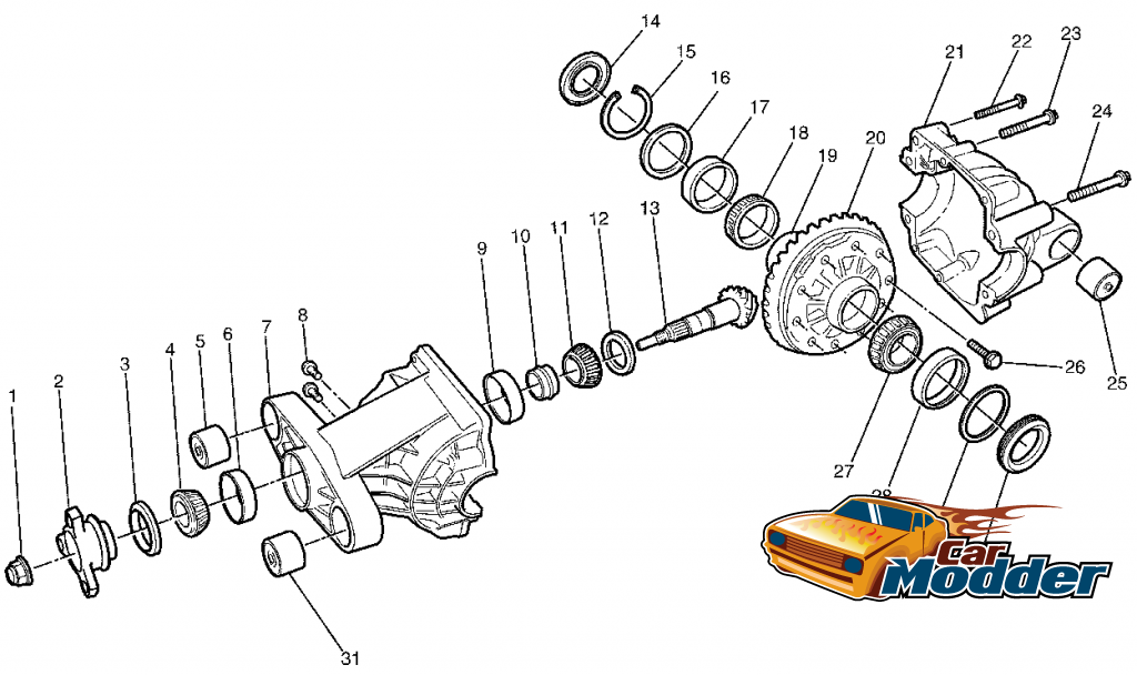

14724
(1) Prevailing Torque Pinion Flange Nut
(2) Pinion Flange
(3) Pinion Flange Oil Seal
(4) Pinion Tail Bearing
(5) Right Front Bushing
(6) Pinion Tail Bearing Cup
(7) Differential Housing
(8) Drain/Fill Plugs
(9) Pinion Head Bearing Cup
(10) Collapsible Spacer
(11) Pinion Head Bearing
(12) Pinion Shim
(13) Pinion Gear
(14) Right Axle Shaft Seal
(15) Circlip
(16) Right Shim
(17) Differential Bearing Cup
(18) Differential Bearing
(19) Differential Assembly
(20) Ring Gear
(21) Differential Housing Cover
(22) Differential Retaining Bolt M10 (6x)
(23) Differential Housing Bolt M14 x 135mm (2x)
(24) Differential Housing Bolt M14 x 100mm (2x)
(25) Rear Bushing
(26) Ring Gear Bolts M12 (10x)
(27) Differential Bearing
(28) Differential Bearing Cup
(29) Left Shim
(30) Axle Shaft Seal
(31) Left Front Bushing
The propeller shaft is a two piece tube supported by a sealed for life centre bearing and non-servicable universal joint. Only vehicles fitted with 4-speed transmissions have a splined slip yoke at the front of the propeller shaft which slides directly into the transmission. The splined slip yoke type propeller shaft has a sealed for life centre bearing and non-servicable universal joint. It has a rubber coupling at each end joining the propeller shaft to the transmission and the differential. All propeller shafts are fixed to the rubber couplings by 3 bolts and 3 torque prevailing nuts which are discarded when removed. Torque prevailing nuts have a low friction coating to ensure no damage to the coupling when assembled, correct nuts must be used. The rubber couplings are then mounted to the differential with 3 bolts and the transmission with 3 bolts and 3 torque prevailing nuts which are also discarded when removed. The centre bearing assembly is fixed to the body with 2 bolts. The two-piece propeller shaft is used to transmit power from the transmission to the differential. The centre bearing and rubber couplings are used to support and connect the propeller shaft and decrease vibration, noise and harshness
