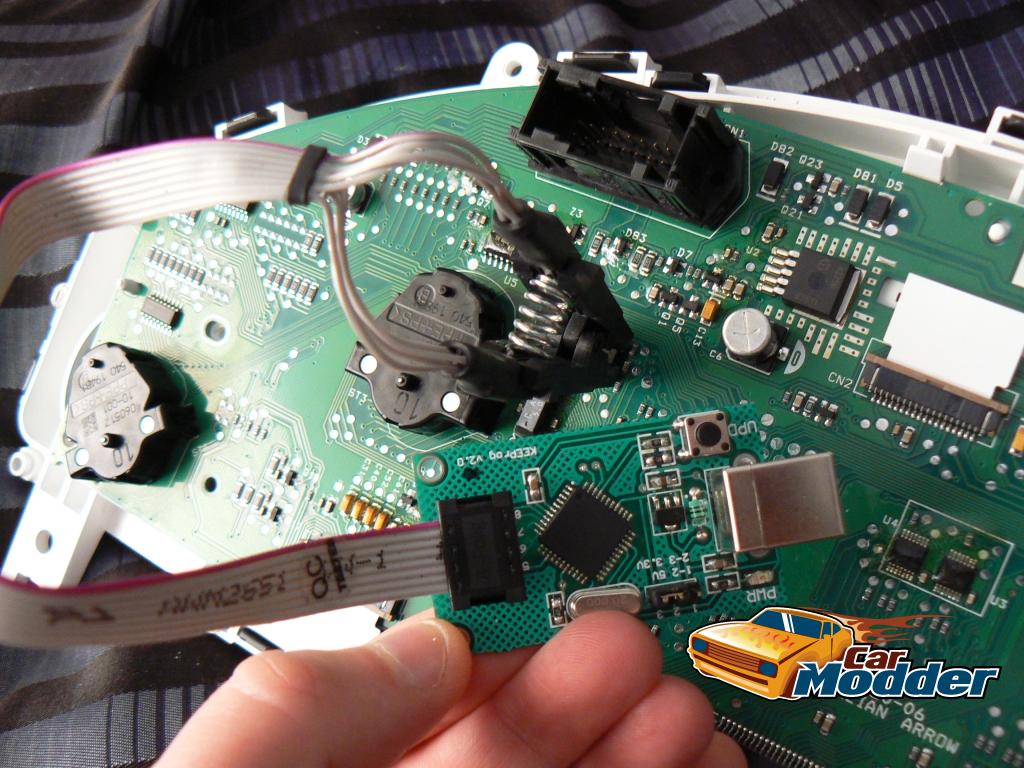

I was wondering does anybody know where I can get the ribbon lead that goes from the 3M Test clip to the Programmer?
I ordered the 3m Test clip from the link in the write up (element14) but it doesn't come with the cable. I have found a test clip + cable on Ebay in the UK but since I now already have a cable I really don't want 2 3M test clips etc if I can help it.
Any help would be greatly appreciated

Postby Morris70 » Fri Dec 21, 2012 8:46 am
The Keeprog turned out to be a waste of money - it took a month to arrive, and won't work with the headunit or 24c04 cluster eeproms.
Besides which, the software for it sucks !
In the end I built a couple of Ponyprog compatible serial programmers out of stuff I had lying around.
One is Max232 based and suits the Headunit and Cluster eeproms (I2C), and the other uses zeners and suits the HCM (microwire)
The Max232 inverts it's outputs, so the polarity of the control lines needs to be inverted in Ponyprog for it to work properly

Postby Morris70 » Sat Dec 22, 2012 10:34 pm
The Keeprog works, but only with the HCM eeprom - The 24c16 headunit and 24c04 cluster eeproms aren't on the list of supported devices, and didn't seem to read properly

Postby IL1CIT » Sun Apr 14, 2013 12:03 am
Been trying too figure out my GQ 4X today, lastnight i posted up some bins from 2 vy clusters, one that i have since found too be a bad read,
Now today the programmer isn't reading, its either reading and picking up nothing, freezing or doing nothing on the reading screen,
Any ideas anyone or is the programer a dud? :(
Tom
IL1CIT
Posts: 21
Joined: Wed Apr 10, 2013 8:15 pm
Postby TazzI » Sun Apr 14, 2013 4:14 pm
Are you sure you have it connected up right?
Are you desoldering the eeprom or using a clip?
If its facing the wrong way round then it either doesnt read anything or displays blanks!
