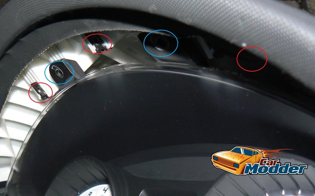

2) With the strip removed remove the 3 screws holding the luster surround plastic just above the instrument cluster
14141

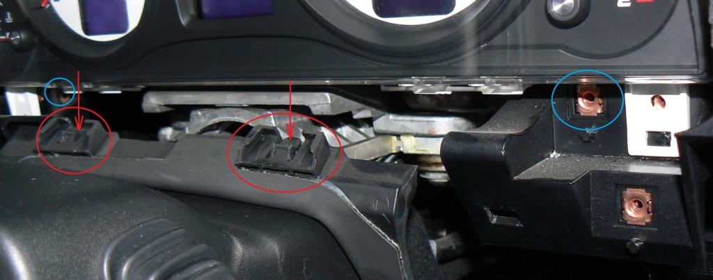

3) Locate the 2 screws holding the bottom of the cluster surround and remove
4) Pop the 2 clips off holding the cluster surround to the steering column rubber surround

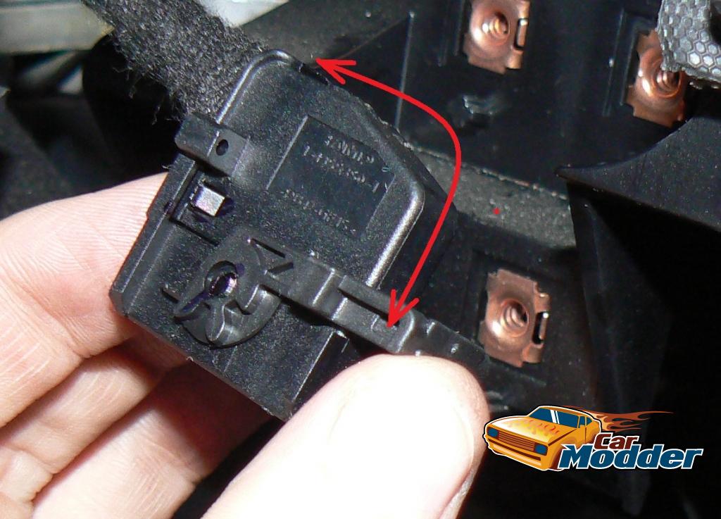

14140
