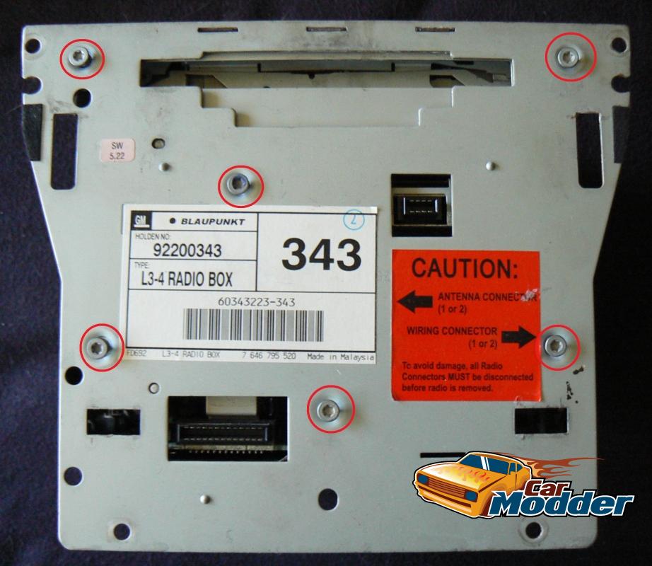

To disassemble the radio/HVAC module you will need the following
A T20 Torx Screwdriver / Allen Key
A T6, Screwdriver / Allen Key
TO disassemble the Main Radio/HVAC module to get access to the EEPROM using a clip will take approximately 10 Minutes on the bench.
This requires the following steps,
1) Remove the 5 T20 Torx Screws holding the faceplate in place

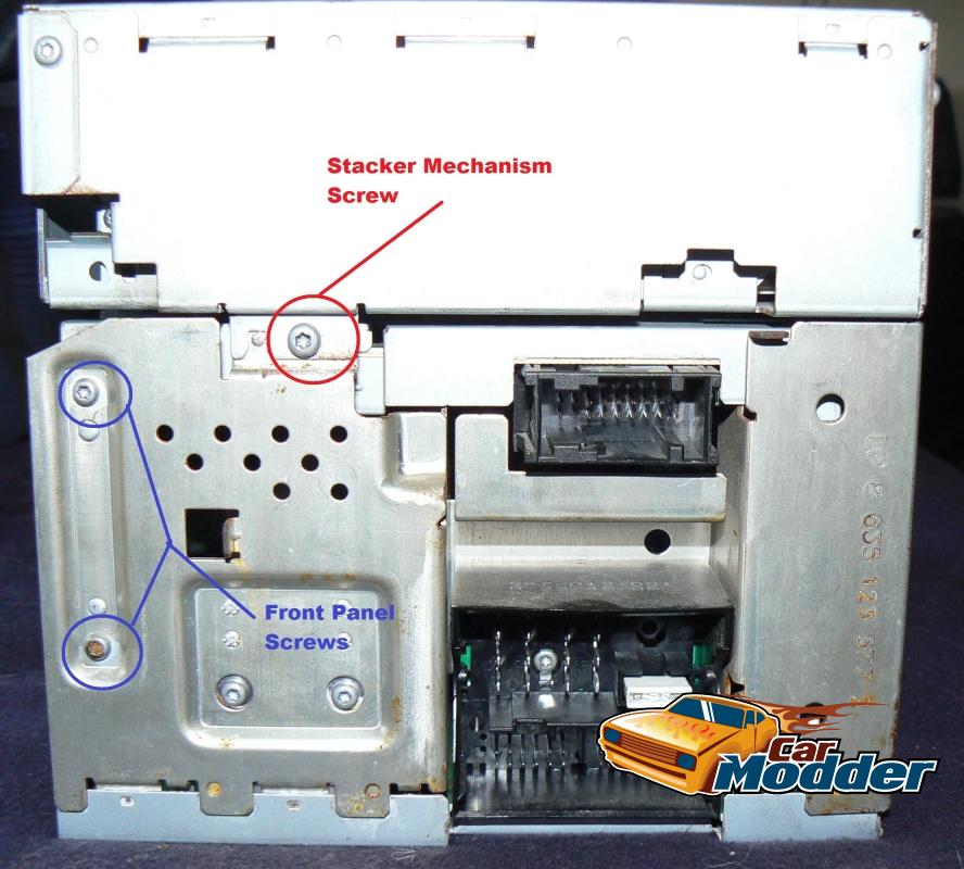

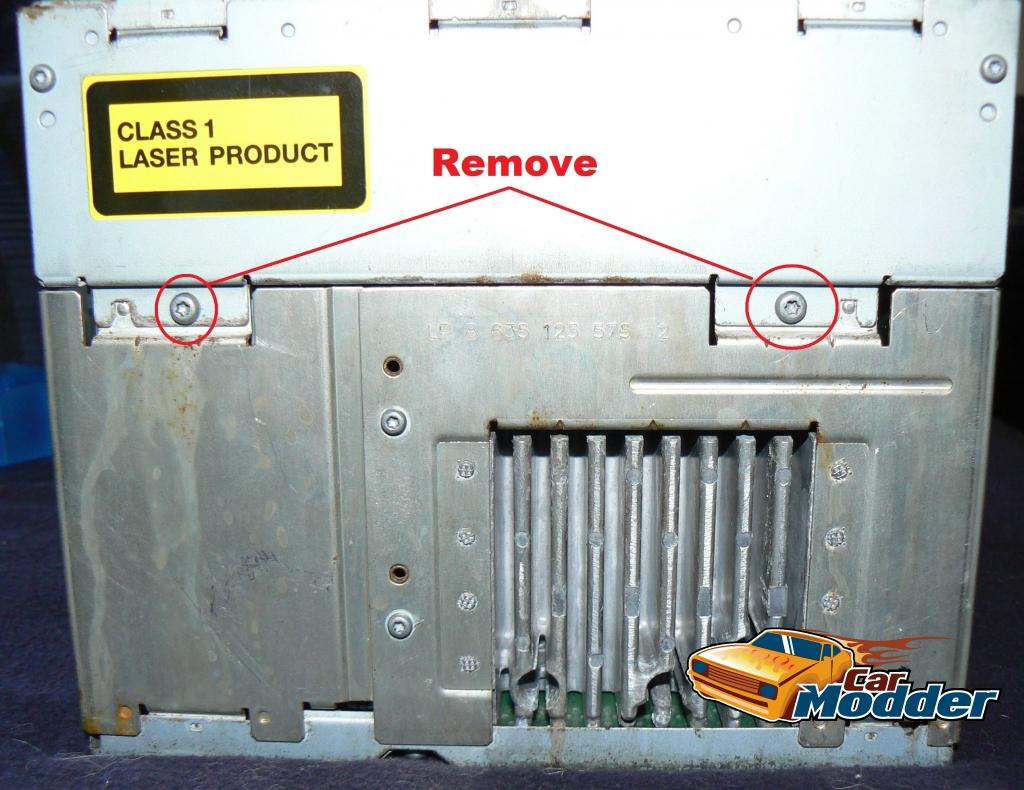

3) Remove the 4 T6 Torx Screws holding the CD Stacker mechanism in place.
See the following Images for exact locations
14595
14594
14589

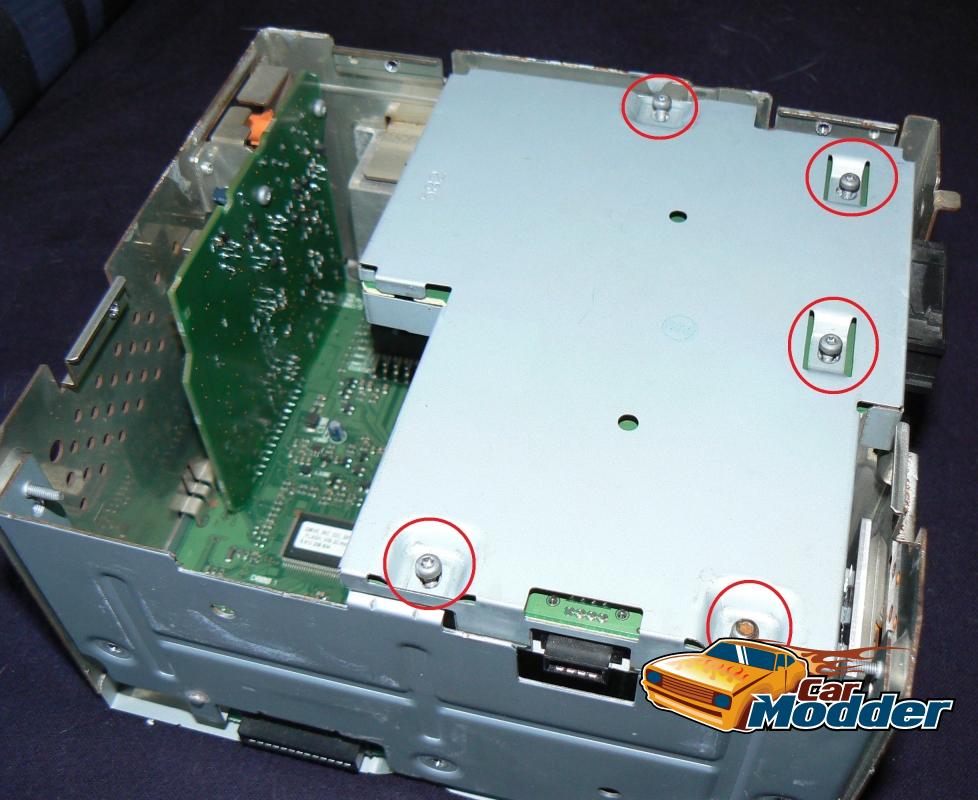

6) Remove the 5 T6 screws holding the LCD Backlight inverter board in place.
14597

9) Remove the four screws holding the front cabinet panel in place.
These are the screws highlighted in Blue in the following images..
14595
14594

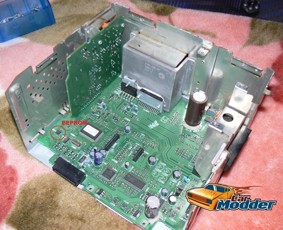

11) Clip the 3M SOP Clip on the EEPROM Chip
14591

Postby ZerOne » Mon Nov 14, 2011 8:26 pm
I wrote the new VIN to the Main board EEPROM, and have put the Radio/HVAC module back together.
But I havent had time to pull my existing radio out, and try to swap it over.
(Also, I removed the EEPROM on the fascia, as you cannot read that EEPROM whilst it is on the board)..
My plan is to solder a lead and socket to it, so as I can quickly test EEPROM bins on the thing, but again I haven't had any time to do that yet....
I was hoping to do the same with the main EEPROM, but it looks like it is glued and soldered to the board, so I have had no luck removing the chip.... (Im also a bit worried, as these modules go for around $400 to $500.... A bit too much $$$ for me to brick the thing)...
