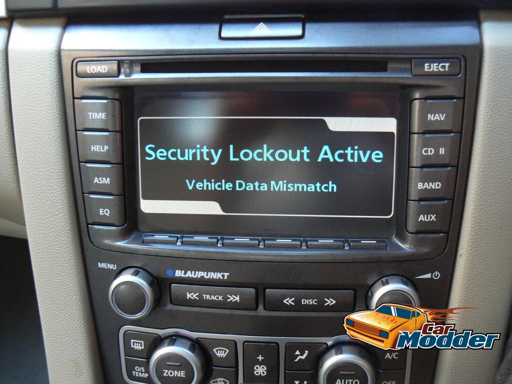

Postby ZerOne » Sat Dec 10, 2011 6:31 pm
Ok, some small progress...
I got my second LCD fascia working again, complete with its EEPROM socket plug.
Here is a picture of the new face, when I originally got it and connected it to my original main unit...
14604
And here is the new face, running on my original main unit, with a copy of the Original Fascia EEPROM....
14605
Postby ZerOne » Sat Dec 10, 2011 6:36 pm
Now that I have a face that I can swap EEPROMs in and out quickly, I need to do the following....
1) See if I can get the larger EEPROMs that I have lying around to work with the fascia unit, as currently I only have the one original EEPROM from the new Fascia unit to play with... (Which will make progress rather slow !!!!!)
2) Trying changing some values and see what happens... (Not that I expect much to change here, as I am thinking that most of the good stuff is located on the main units EEPROM)...
3) Try connecting my second Main Unit up, with the second Fascia EEPROM, to see if setting the VIN number works.. (I dont see any reason why it shouldnt work at this stage)....
4) Try and change some settings on the main unit EEPROM.... (!?!?!?!?!?!)
