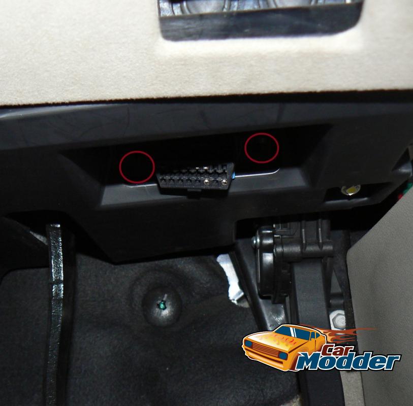

Here is the location of the OBDII Connector if anyone is interested..
14160

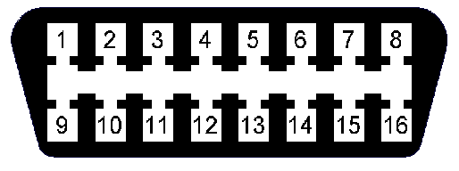

14795
The pinouts for this are for the connector on the vehicle.
GM OBDII Connector Pinout
GM cars produced in 2003-2006 use J1850-VPW interface or CAN BUS
Pin 1 - SW-LS-CAN (33kB) or DW-FT-CAN (+) (<125kB)
Pin 2 - J1850
Pin 3 - MS-CAN (+) (95kB)
Pin 4 - Battery - (Chassis Ground)
Pin 5 - Signal Ground
Pin 6 - ISO 15765 HS-CAN (+) (500kB)
Pin 7 - K-Line
Pin 8 -
Pin 9 - DW-FT-CAN (-) (<125kB)
Pin 10 - PWM
Pin 11 - MS-CAN (-) (95kB)
Pin 12 - K-Line (KW82 Prot.)
Pin 13 - Reserved
Pin 14 - ISO 15765 HS-CAN (-) (500kB)
Pin 15 - L-Line
Pin 16 - Battery + (Constant 12V Power)
