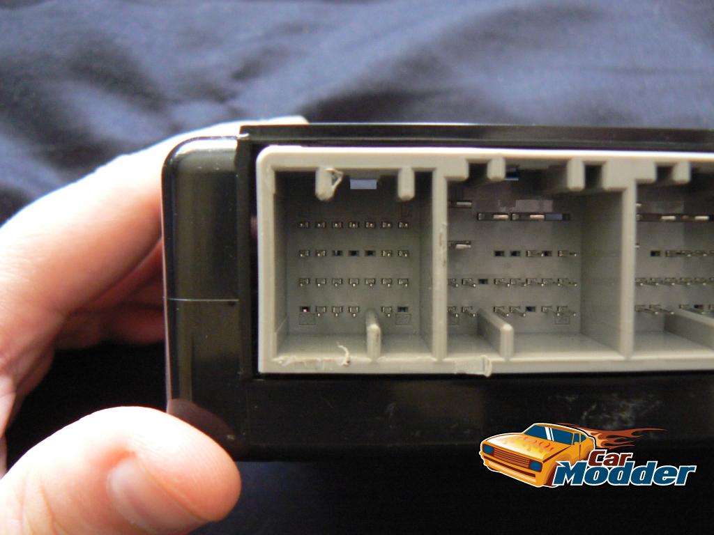

Postby ZerOne » Sat Feb 25, 2012 9:45 am

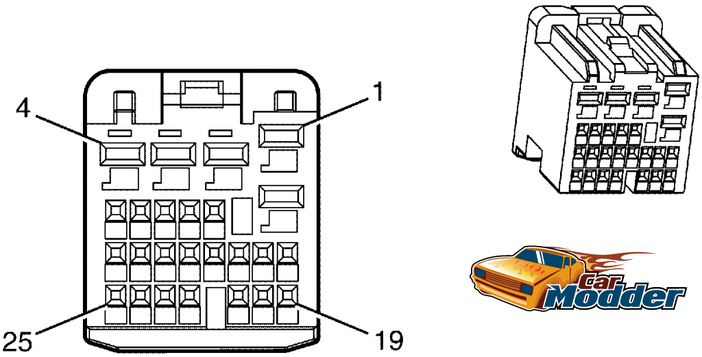

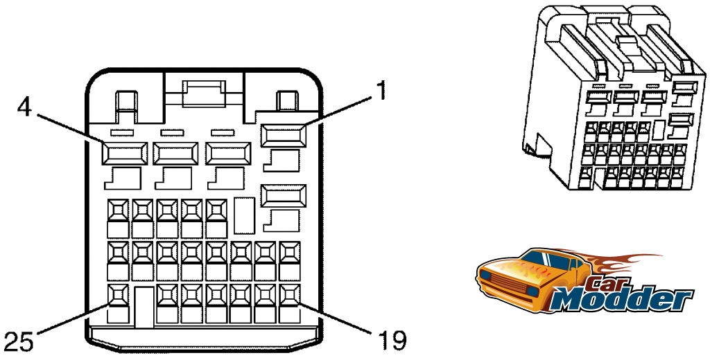

BCM Wiring Connectors
14792
14794
BCM X1 Wiring Connector
14793
14782
Pin 1 - Not Used
Pin 2 - White                    - Ignition Key Resistor Low Reference
Pin 3 - Grey                      - Cruise Control Switch Signal
Pin 4 - White / Black Stripe - Ignition Key Resistor Signal
Pin 5 - Light Green            -  Windshield Wiper Switch High Signal
Pin 6 - Not Used
Pin 7 - Not Used
Pin 8 - Black / White Stripe - Wiper Switch Low Reference
Pin 9 - Light Blue              - Windshield Wiper Switch Low Signal
Pin 10 - Not Used
Pin 11 - Not Used
Pin 12 - Not Used
Pin 13 - Not Used
Pin 14 - Pink                   - Run / Crank Voltage
Pin 15 - Light Blue / White - Left Turn Signal Switch Signal
Pin 16 - Dark Blue / White  - Right Turn Signal Switch Signal
Pin 17 - Purple                 - Remote Radio Control Supply Voltage
Pin 18 - Purple / Yellow     - Headlamp Dimmer Switch High Beam Signal
Pin 19 - Not Used
Pin 20 - Purple / Red        - Transmission Electronic Range Select Signal
Pin 21 - Brown                - Ignition 1 Voltage
Pin 22 - Not Used
Pin 23 - Yellow               - Left Tail Lamp Monitoring (HSV)
Pin 24 - Orange              - Windshield Washer Switch Signal
Pin 25 - Brown / Red       - Flash To Pass Switch Signal

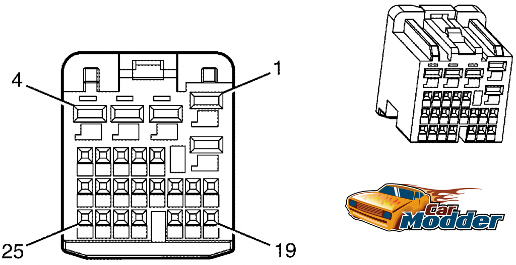

BCM X2 Wiring Connector
14783
Pin 1 - Orange                  - Inadvertent Power Supply Voltage
Pin 2 - Orange / Blue         - Battery Positive Voltage
Pin 3 - Grey                      - Instrument Panel Lamp Supply Voltage
Pin 4 - Not used
Pin 5 - Dark Blue / White     -  Courtesy Lamp Supply Voltage
Pin 6 - Not Used
Pin 7 - Not Used
Pin 8 - Brown / White         - Park Lamp Switch On Signal
Pin 9 - Not Used
Pin 10 - Dark Blue              - Rear Compartment Relay Switch
Pin 11 -Light Green / Black  - DRL Ambient Light Sensor Signal\
Pin 12 - White                  - Headlamp Switch Headlamps On Signal
Pin 13 - Not Used
Pin 14 - Not Used
Pin 15 - Not Used
Pin 16 - Not Used
Pin 17 - Dark Green           - Headlamp Switch Headlamps Off Signal
Pin 18 - Pink / Black          - Courtesy Lamps Switch Signal
Pin 19 - Not Used
Pin 20 - Light Blue            - Tow/Haul Switch Signal
Pin 21 - Brown / Orange    - Traction Control Switch Signal
Pin 22 - Dark Green / White - A/T Shift Lock Control Solenoid Supply Voltage
Pin 23 - Not Used
Pin 24 - Not Used
Pin 25 - Purple                 - Interior Lamp Switch Signal

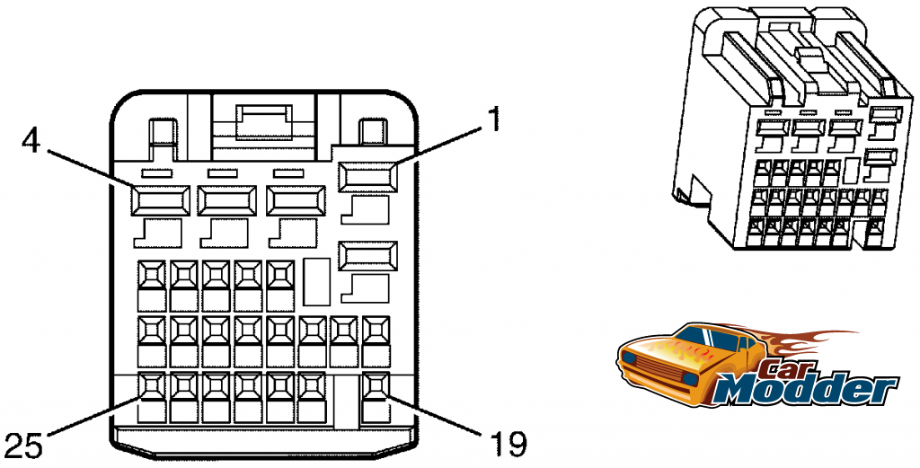

BCM X3 Wiring Connector
14784
Pin 1 - Black                     - Ground
Pin 2 - Orange / Yellow       - Battery + Voltage
Pin 3 - Orange / Red          - Battery + Voltage
Pin 4 - Not Used
Pin 5 - Black                     - Ground
Pin 6 - Not Used
Pin 7 - Grey                      - Security Indicator Control
Pin 8 - Brown / Black          - High Speed Lan Serial Bus +
Pin 9 - Brown                    - High Speed Lan Serial Bus -
Pin 10 - Dark Green            - Low Speed GM Lan Serial Data
Pin 11 - Not Used
Pin 12 - Not Used
Pin 13 - Light Green           - Stop Lamp Switch Signal
Pin 14 - Brown / Red          - Low Reference
Pin 15 - Grey                    - 5V Reference
Pin 16 - Brown / Black        - High Speed Lan Serial Bus +
Pin 17 - Brown                  - High Speed Lan Serial Bus -
Pin 18 - Yellow                 - LED Backlight Dimming Control
Pin 19 - Purple / White       - Communication Enable Relay Control
Pin 20 - Not Used
Pin 21 - Orange                - Fog Lamps Switch
Pin 22 - Not Used
Pin 23 - Not Used
Pin 24 - Not Used
Pin 25 - Purple / White      - RPA Switch LED Dimming Control

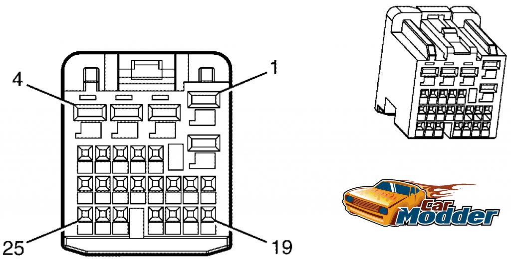

BCM X4 Wiring Connector
14785
Pin 1 - Orange / Red          - Battery + Voltage
Pin 2 - Orange                  - Battery + Voltage
Pin 3 - Orange / Purple       - Battery + Voltage
Pin 4 - Orange / Purple       - Battery + Voltage
Pin 5 - Dark Blue /White     - Right hand side turn signal supply voltage
Pin 6 - Not Used
Pin 7 - Yellow                   - Windscreen Wiper Motor Park Switch Signal
Pin 8 - Not Used
Pin 9 - Black                    - Ground
Pin 10 - Orange / Blue       - Battery + Voltage
Pin 11 - Dark Green / White - Fog Lamps Relay Control
Pin 12 - Not Used
Pin 13 - Not Used
Pin 14 - Orange                - Outside Moisture Sensor Signal 2
Pin 15 - Orange                - Washer fluid pump relay control
Pin 16 - Brown / Yellow      - Headlamp High Beam Relay Control
Pin 17 - Pink / Black          - Hood Ajar Switch Signal
Pin 18 - Brown                 - Outside Moisture Sensor Signal 1
Pin 19 - Dark Blue             - Accessory Wakeup Serial Data
Pin 20 - Not Used
Pin 21 - Pink                    - Run / Crank Control
Pin 22 - Brown                 - Boot Release Relay Control
Pin 23 - Not Used
Pin 24 - Dark Green          - Backup Lamp Relay Control
Pin 25 - Not Used

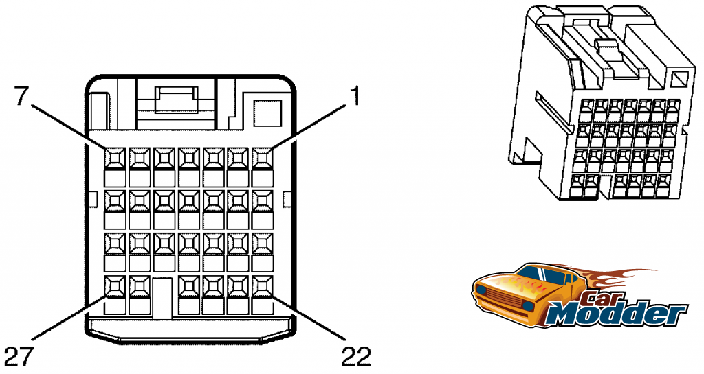

BCM X7 Wiring Connector
14788
Pin 1 - Not Used
Pin 2 - White                    - Headlamp Washer Relay Control
Pin 3 - Not Used
Pin 4 - Not Used
Pin 5 - Not Used
Pin 6 - Light Blue              - Door Unlock Supply Voltage
Pin 7 - Dark Blue / White    - Door Lock Control
Pin 8 - Not Used
Pin 9 - White                   - Door Unlock Control
Pin 10 - Grey / Blue          - Headlamp Dimming Switch Up
Pin 11 - Brown / Black      - Power Door Unlock Fuse Supply Voltage
Pin 12 - Grey / Black        - Power Door Lock Fuse Supply Voltage
Pin 13 - Not Used
Pin 14 - Not Used
Pin 15 - Not Used
Pin 16 - Light Blue           - Fog Lamp Switch Output Rear
Pin 17 - Not Used
Pin 18 - Not Used
Pin 19 - Not Used
Pin 20 - Not Used
Pin 21 - Not Used
Pin 22 - Not Used
Pin 23 - Grey / White       - Headlamp Dimming Switch Down
Pin 24 - Not Used
Pin 25 - Not Used
Pin 26 - Not Used
Pin 27 - Not Used
Pin 28 - Not Used

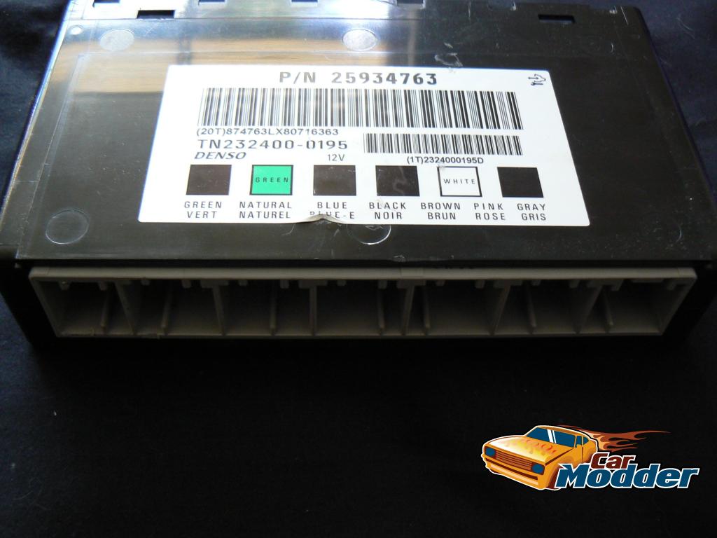

Postby doubledip » Mon Mar 05, 2012 10:28 pm
2009 VE BCM Bin
