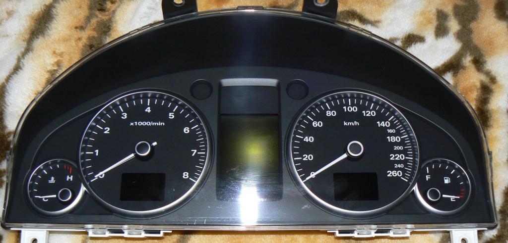

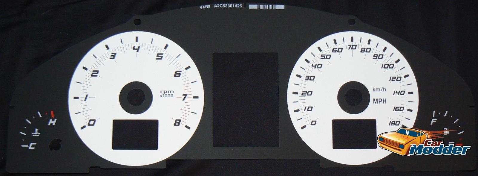

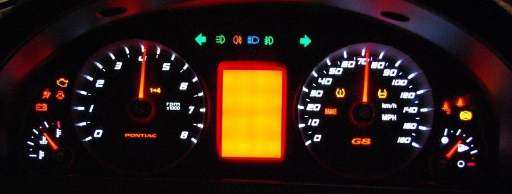

Here is the Vauxhall VXR8 E1/E2 fascia, the Newer Vauxhall E3 Fascia, an E1/E2 HSV Fascia and a Pontiac G8 Cluster for comparison
14957 15003
15002 14152
What would be required for this conversion ?

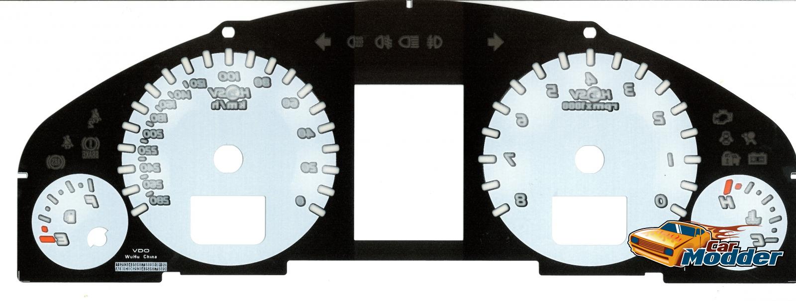

Here is a picture of the Vauxhall VXR8 E1 E2 Cluster Illuminated, and the VXR8 E3 Cluster Illuminated.
557 15008

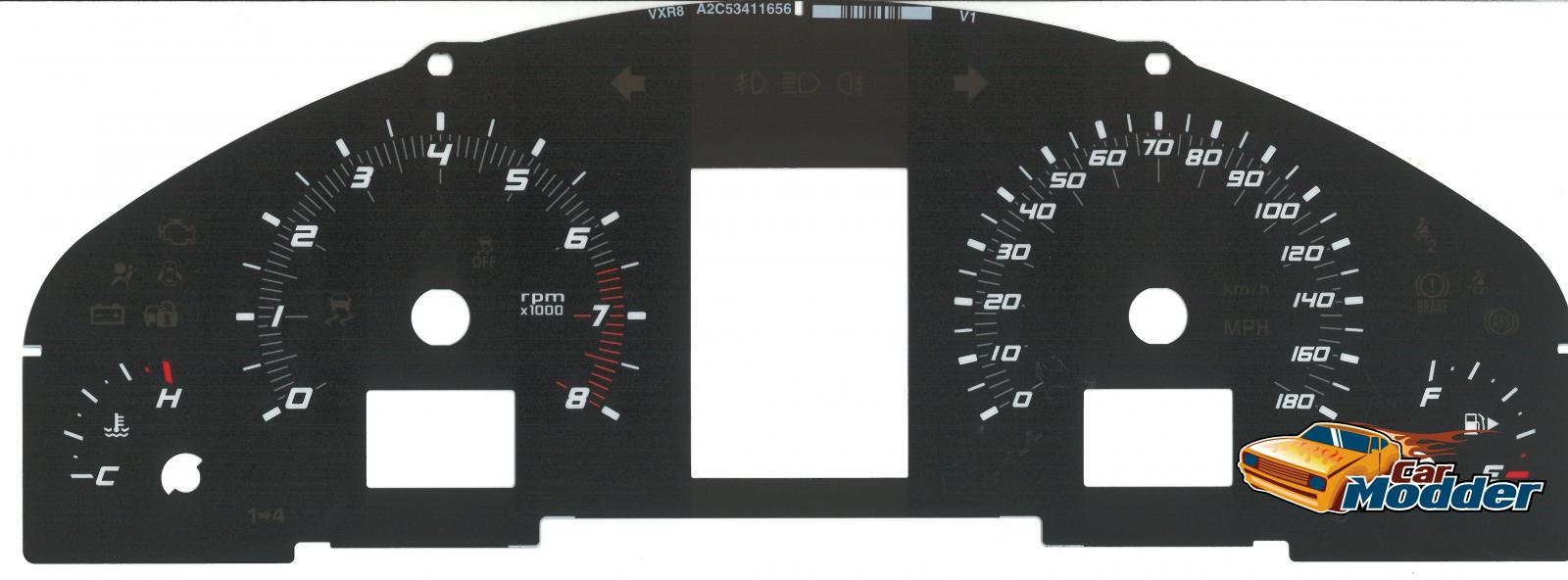

Scanned Vauxhall E1, E2 Cluster Fascia.
(Let me know if anyone wants a copy of these in High Res, and I will post them up)....
14958 14959
Note the location of the 1-> 4 Shift light, and the Rear Fog Lamp Indicator Light.

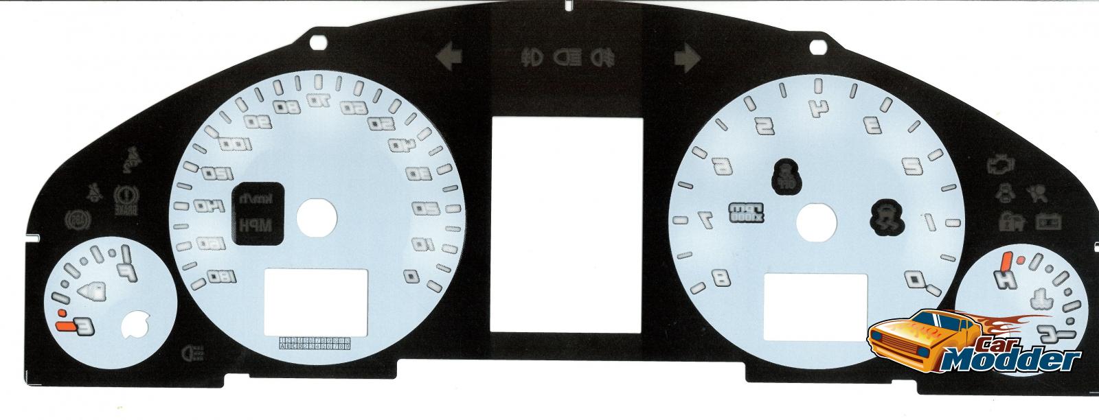

Postby ZerOne » Mon Jun 04, 2012 6:12 pm
Scanned Vauxhall E3 Cluster Fascia.
15006 15007
Note the location of the 1-> 4 Shift light, and the Rear Fog Lamp Indicator Light are located at the bottom of the cluster.
Also Note the traction Control Off, warning light is located where the Pontiac G8 1 -> 4 Warning lamp is located.
A further Loss of traction warning light is also fitted close to the traction control Off warning Lamp.

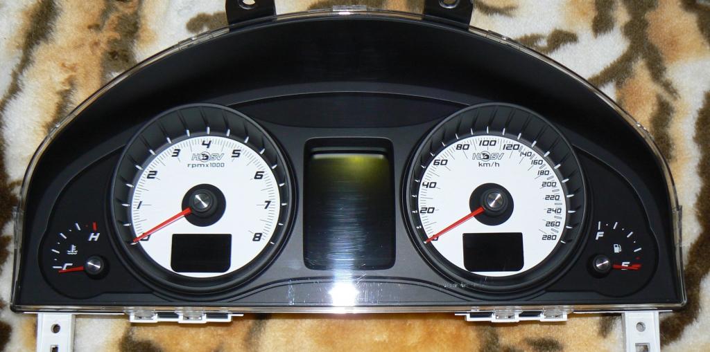

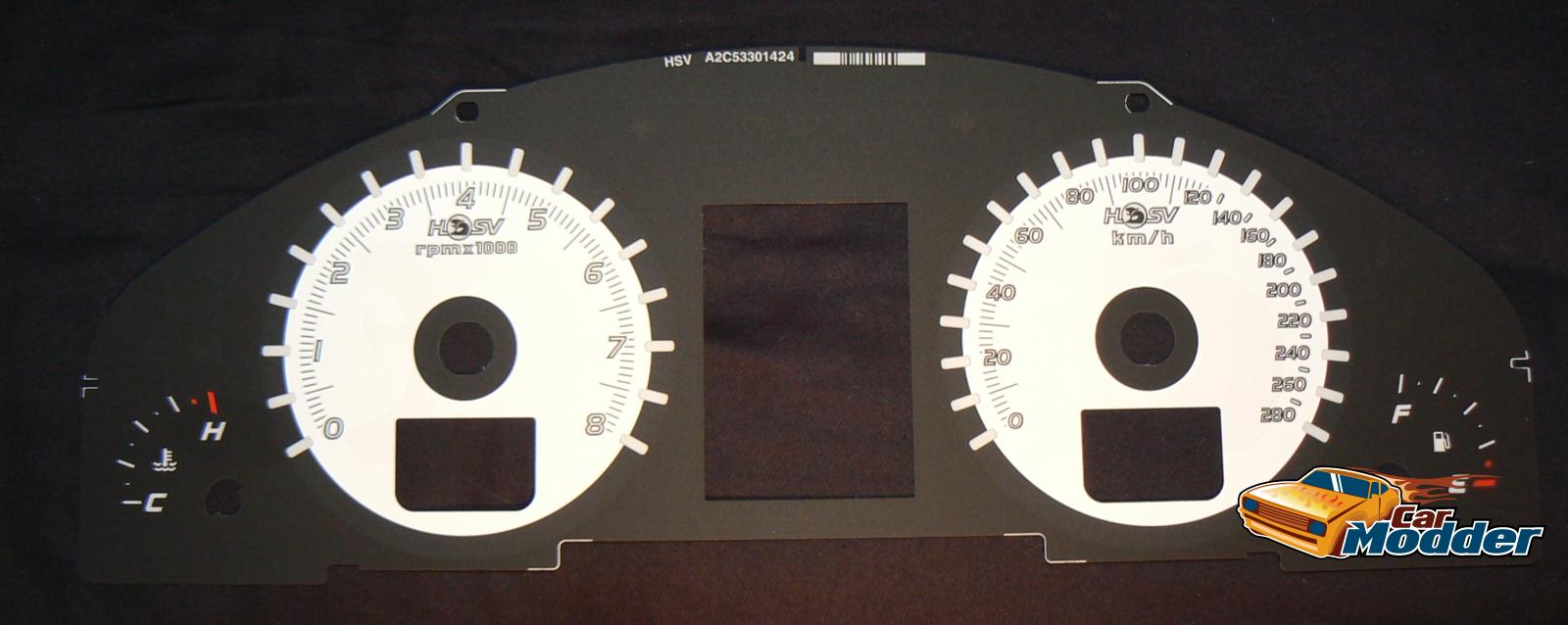

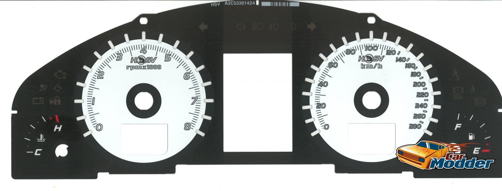

And just because its kind of related, here is a scanned HSV E1/E2 Cluster Fascia.
15005 15004
