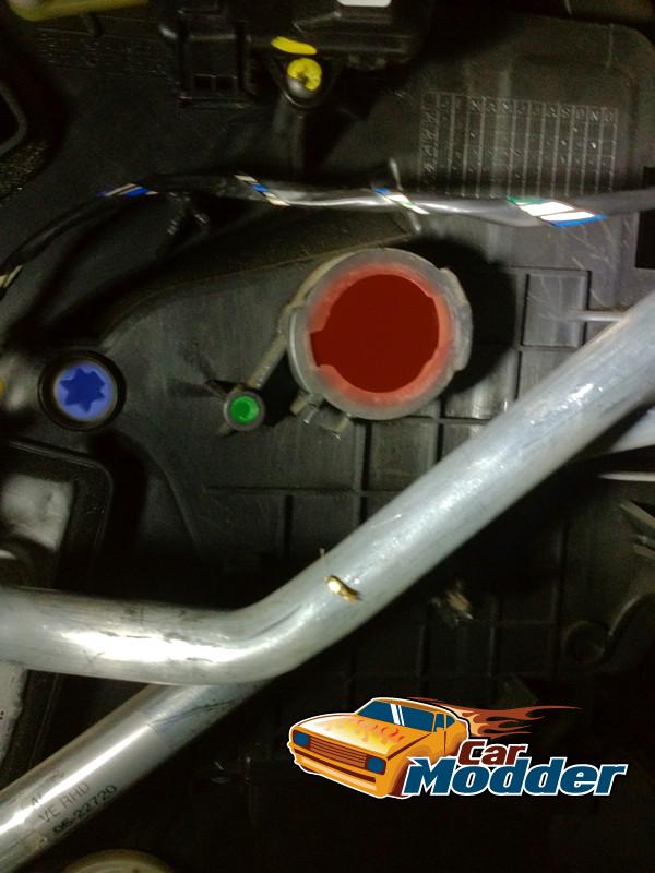

I will try and find some images for you so as you can have a look and hopefully save yourself some money...
Postby ZerOne » Fri Jun 22, 2012 2:46 pm
14996
The above image (Thanks to msenj for posting this one up ;) ) shows a non Dual Zone Climate control box fitted to a VE Commodore.
The Blue Star shaped thing is where the passenger side blend door actuator / motor connects to the airbox...
There should be a module / motor thing screwed in to this location.
(This will be the Blend Door Motor for the Passenger Side)...
Hope this hepls
