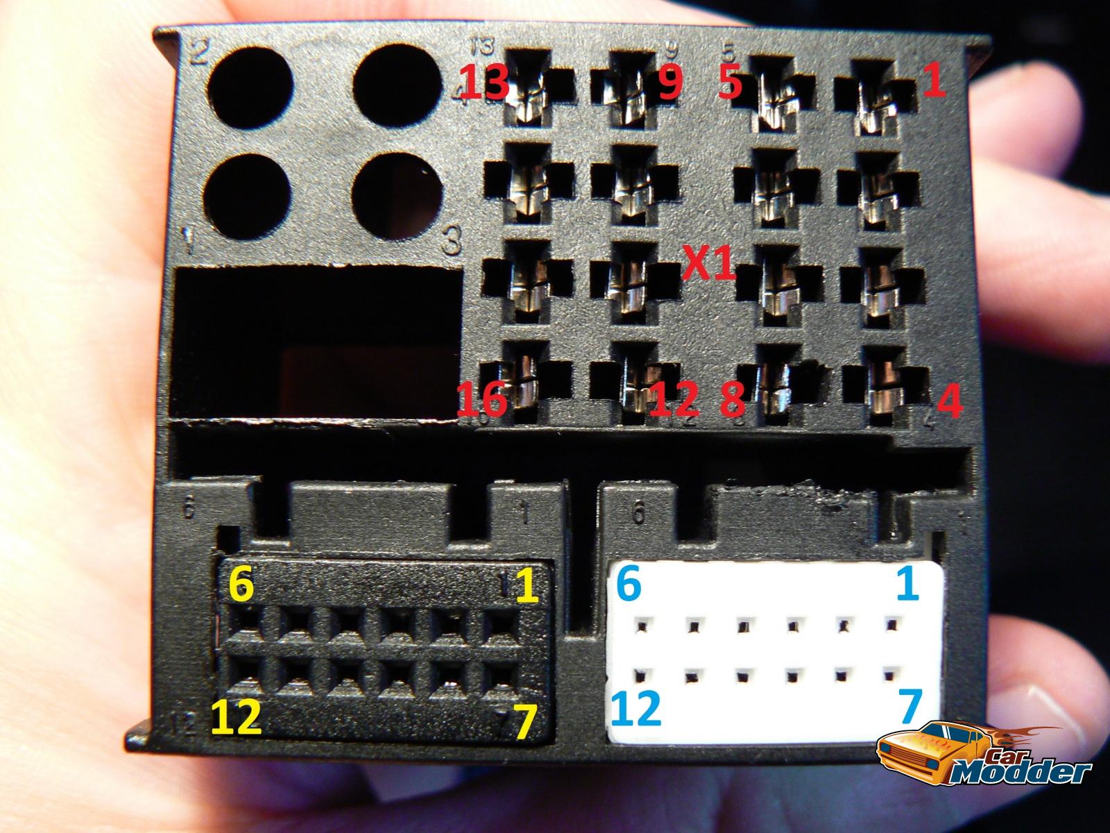

Hey guys I'm wiring up a sub in a series 2 what wires do I connect a in line converter to on the head unit? What side and so on. Not my car so I can't fuck it up lol.

The Series II (IQ units) wiring is very different to the Series I units.
However the Speaker Output wiring is the same (Apart from the front center speaker, which is different) for the Series II IQ Units.
Here is and image of the Wiring Connectors for the IQ unit
15762 15991
Pin 1 - Speaker RR Door (+)
Pin 2 - Speaker RF Door (+)
Pin 3 - Speaker LF Door (+)
Pin 4 - Speaker LR Door (+)
Pin 5 - Speaker RR Door (-)
Pin 6 - Speaker RF Door (-)
Pin 7 - Speaker LF Door (-)
Pin 8 - Speaker LR Door (-)
I hope this helps
