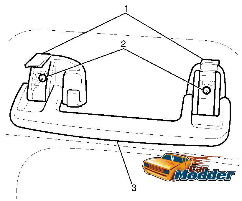

Postby ZerOne » Wed Nov 09, 2011 7:33 pm
14588
•Pull the assist handle (3) into the down position.
•Prise open the assist handle screw covers (1).
•Remove the two retaining torx screws (2).
Important: When removing the assist handle assembly, take care not to damage the locating pins.
•Remove the assist handle assembly (3).
Postby ZerOne » Wed Nov 09, 2011 7:35 pm
It looks like the mounting bits for both the front Drivers and Passenger side grab handles are there.
Ill try and find out more information for you...
