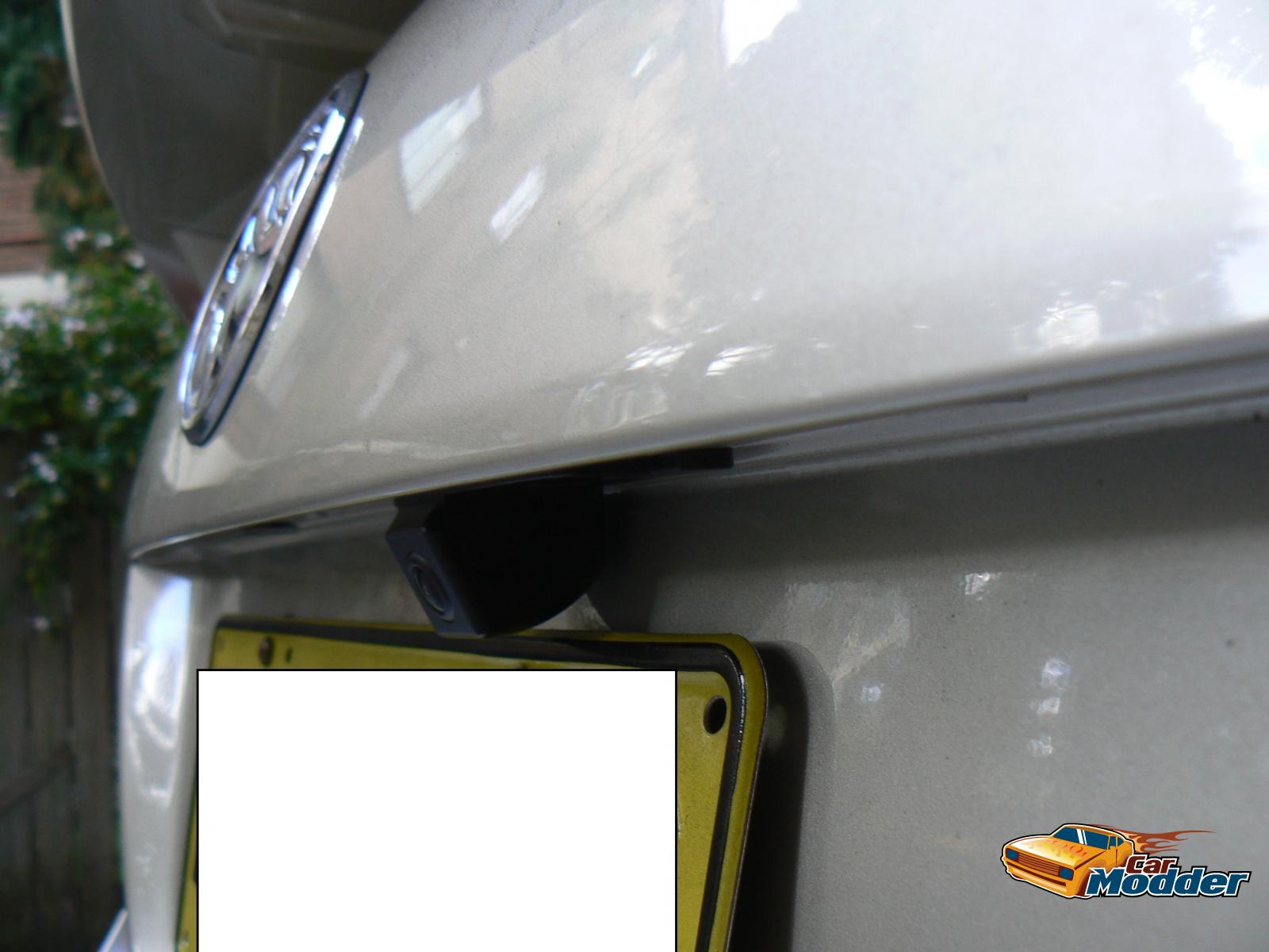

I have been playing around with a couple of cheapy CCD Reverse cameras, and I have found a model
that costs around $30 to buy (from fleabay), that does not require any drilling or boot modification.
More information to come.....

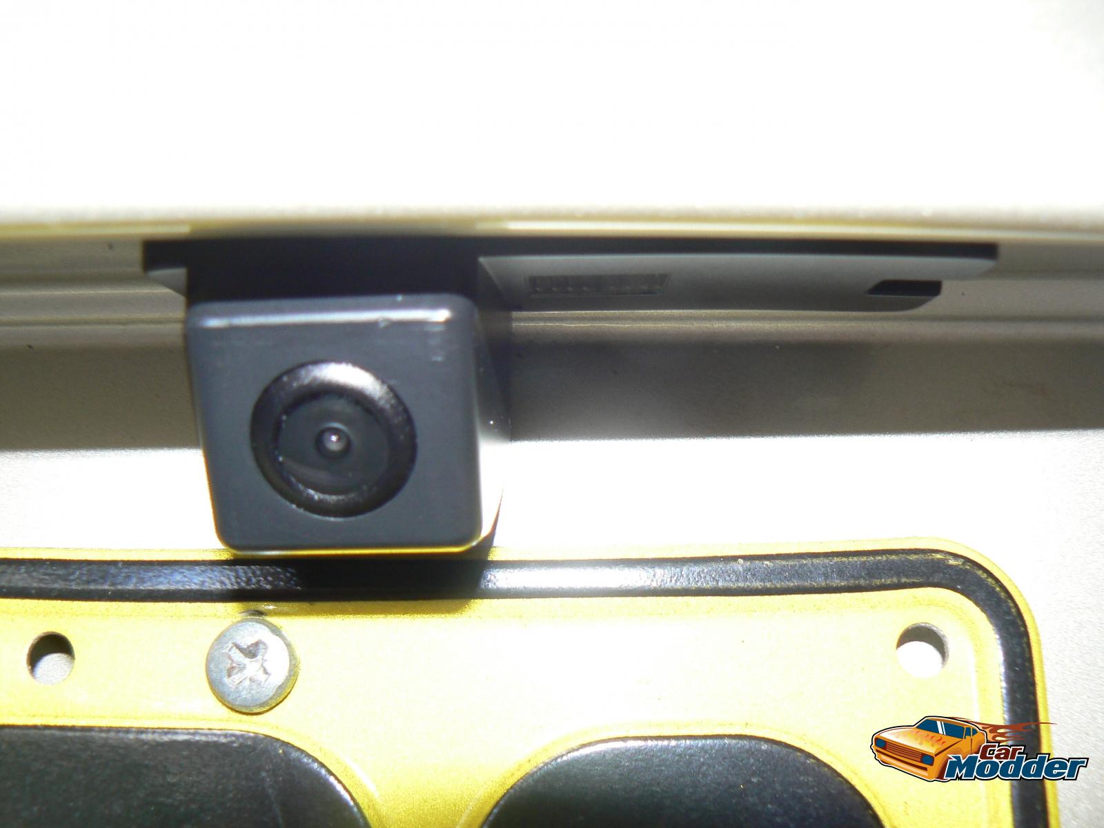

Postby ZerOne » Tue Feb 19, 2013 1:07 pm
The model shown above was advertised as being suitable for VN through to VZ Commodore models,
and simply replaces the existing number plate lamp on the boot.
I have been playing around with a number of different options, trying to find a good quality (CCD, 500+ TVL), but relatively cheap camera
for connecting up the a colour LCD headunit (Such as Series I and IQ units).
The above camera required parts of the housing to be shaved down in order to fit the VE number plate lamp cutout (The main body of the housing was around 1.0mm ~ 1.5mm to thick, so I simply used a dremel to cut back on some of the excess plastic.
I was wondering what other solutions others may have used in mounting / fitting a reverse camera to their vehicle, how hard their solution was to fit, and how the end product looks ?
