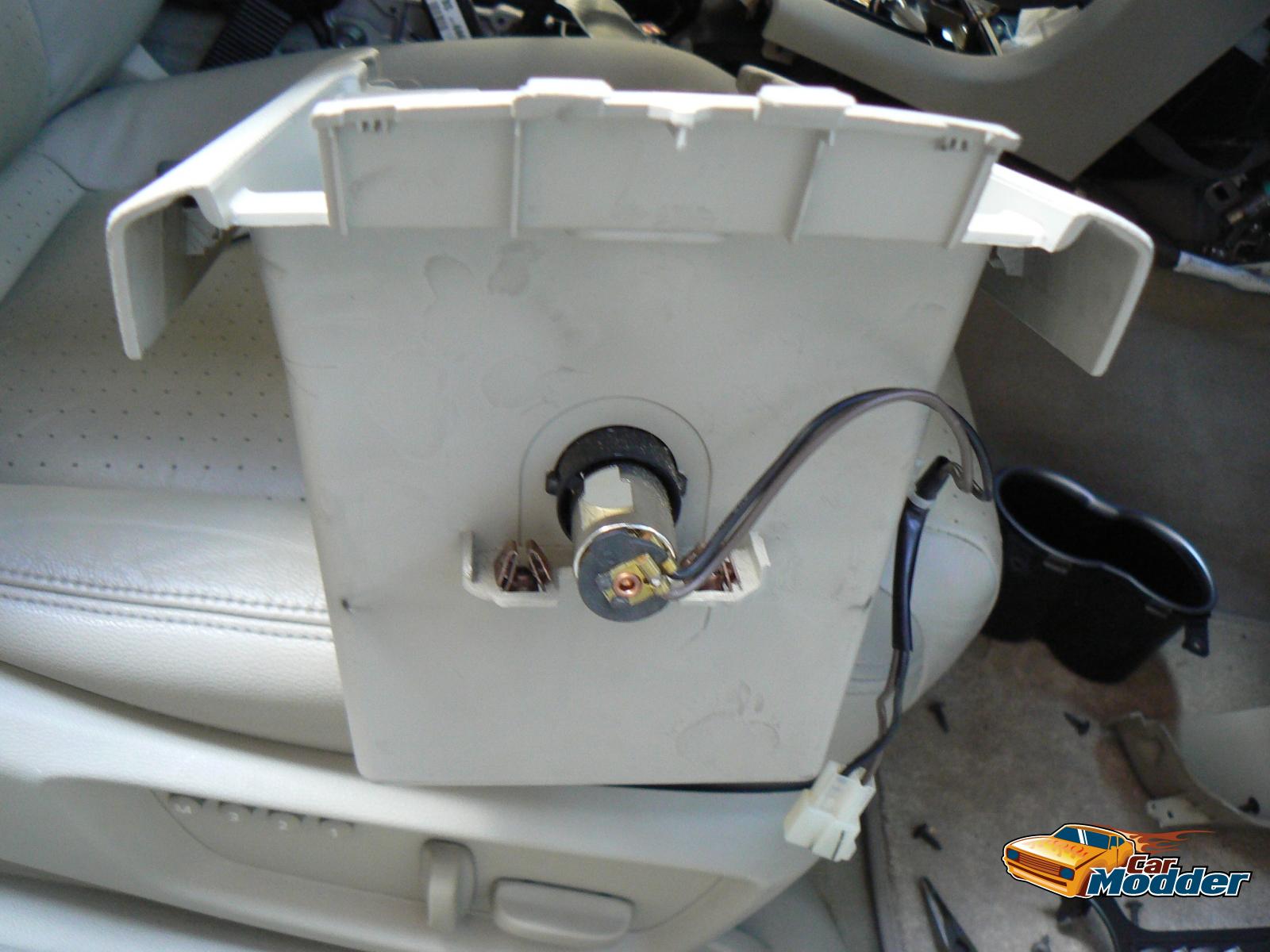

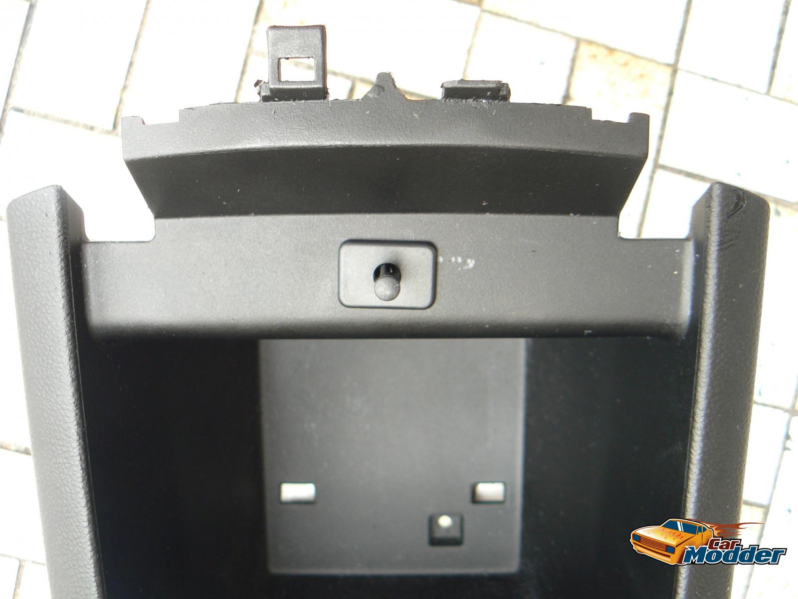

(Here is a picture of the back of the power socket)
16057
As you can see from the above picture (Click on it for a large high res version), the black surround clips in to the center console assembly, and then the power socket is inserted in to the black ring....

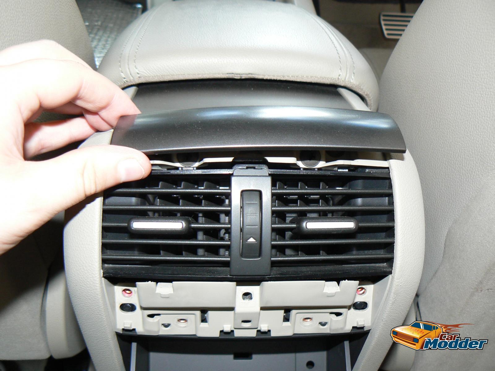

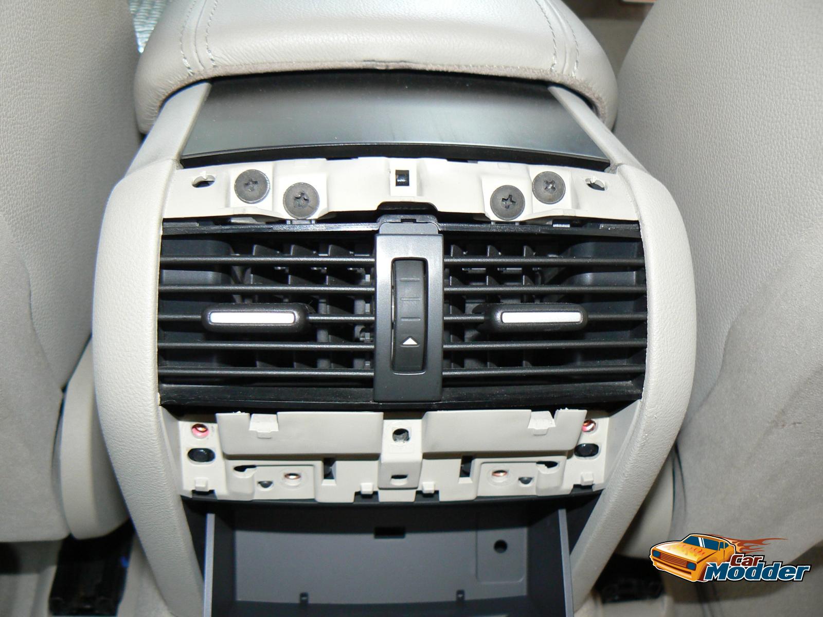

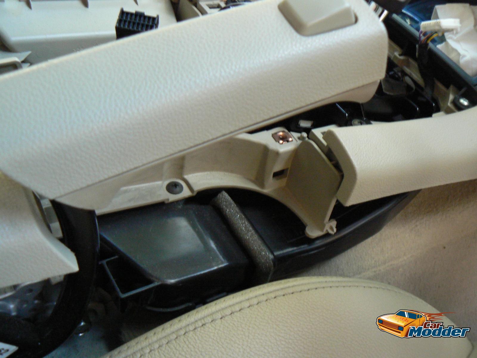

You may be able to get good access to this section by removing the rear vents.
16024 16025
16027 16028

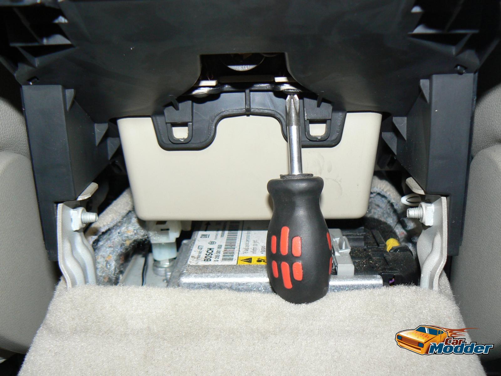

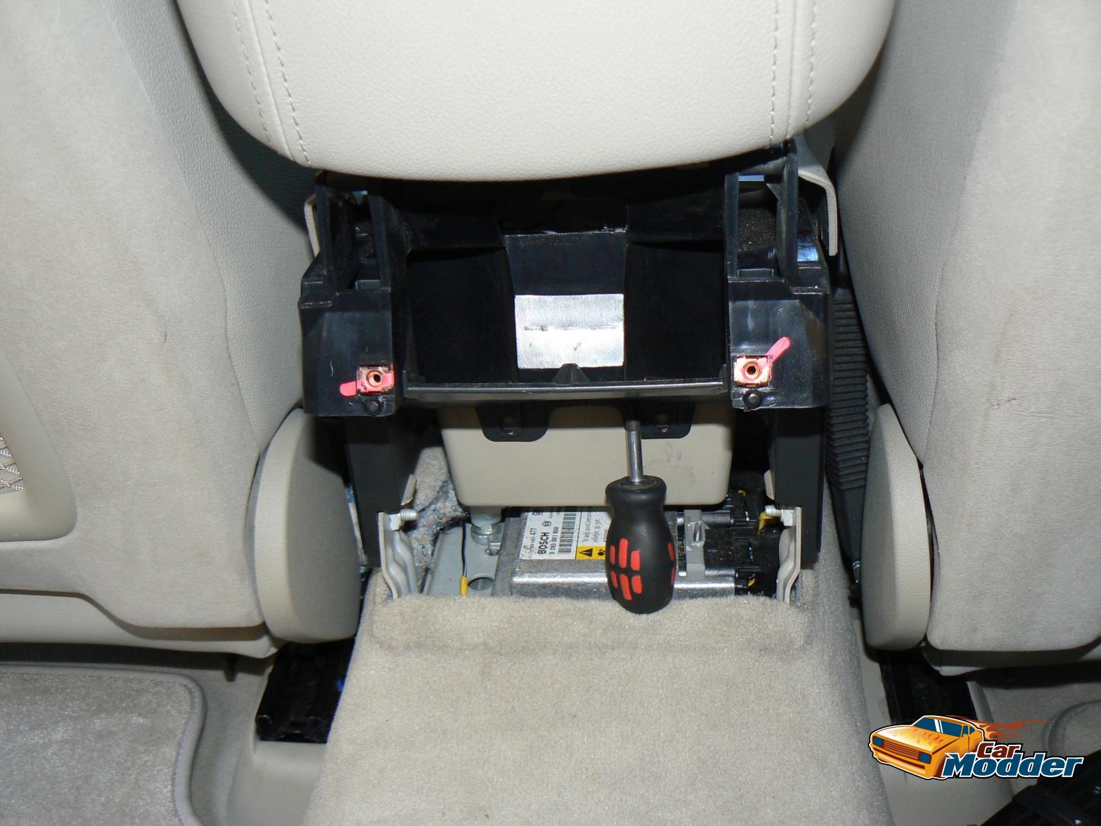

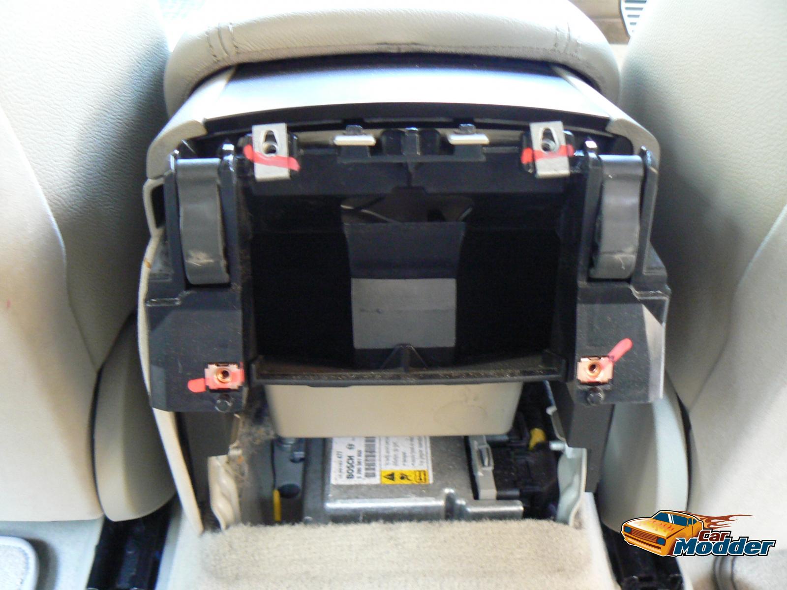

Once you have the vents removed, there are 2 screws holding the console in place.
16048
If you remove these screws, then you will be able to partially move the center console upward, to gain access to this section.
I hope this helps.

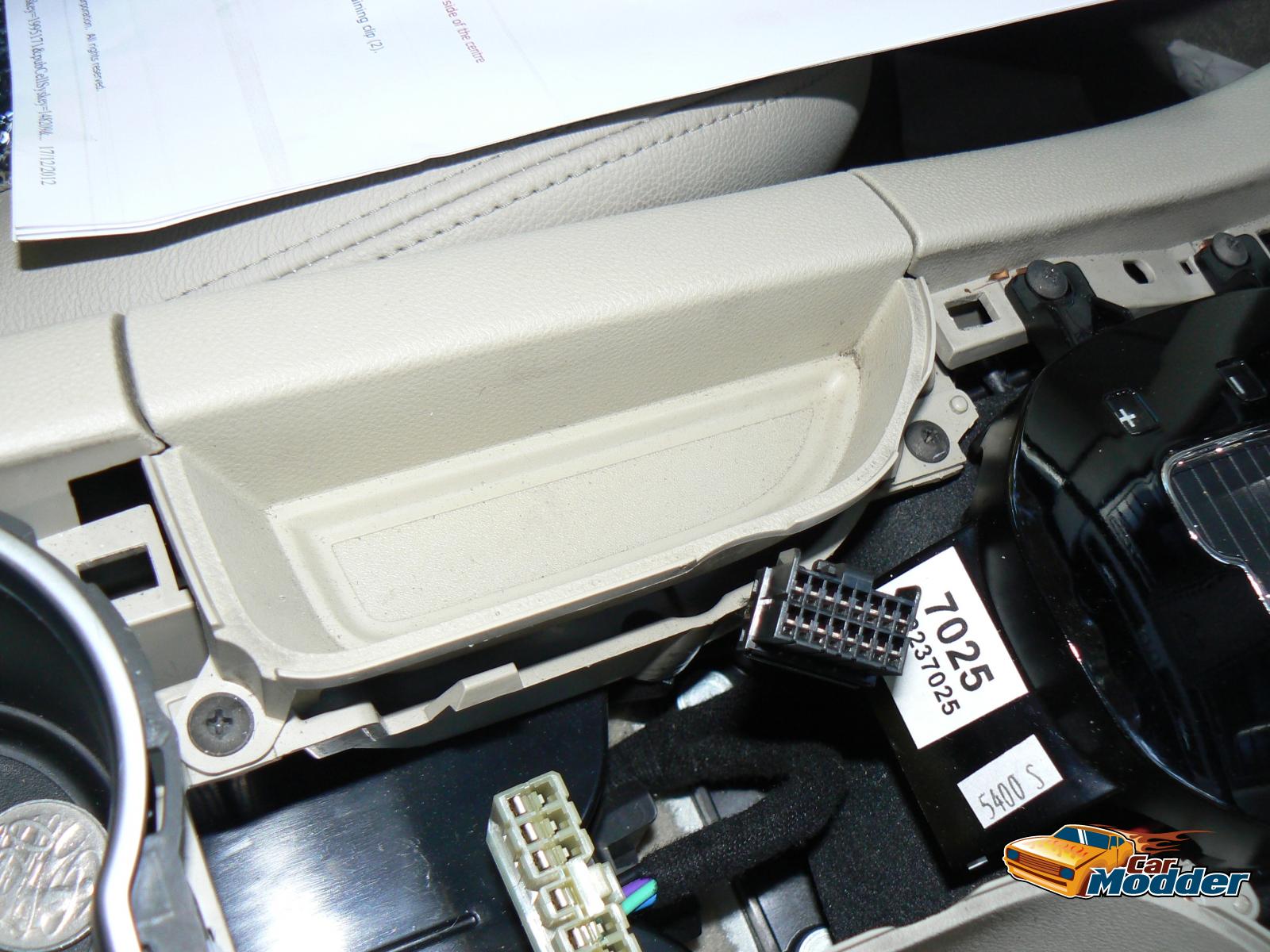

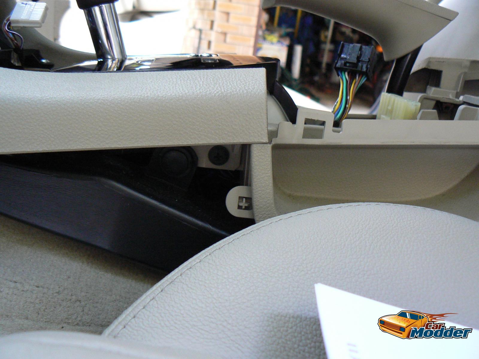

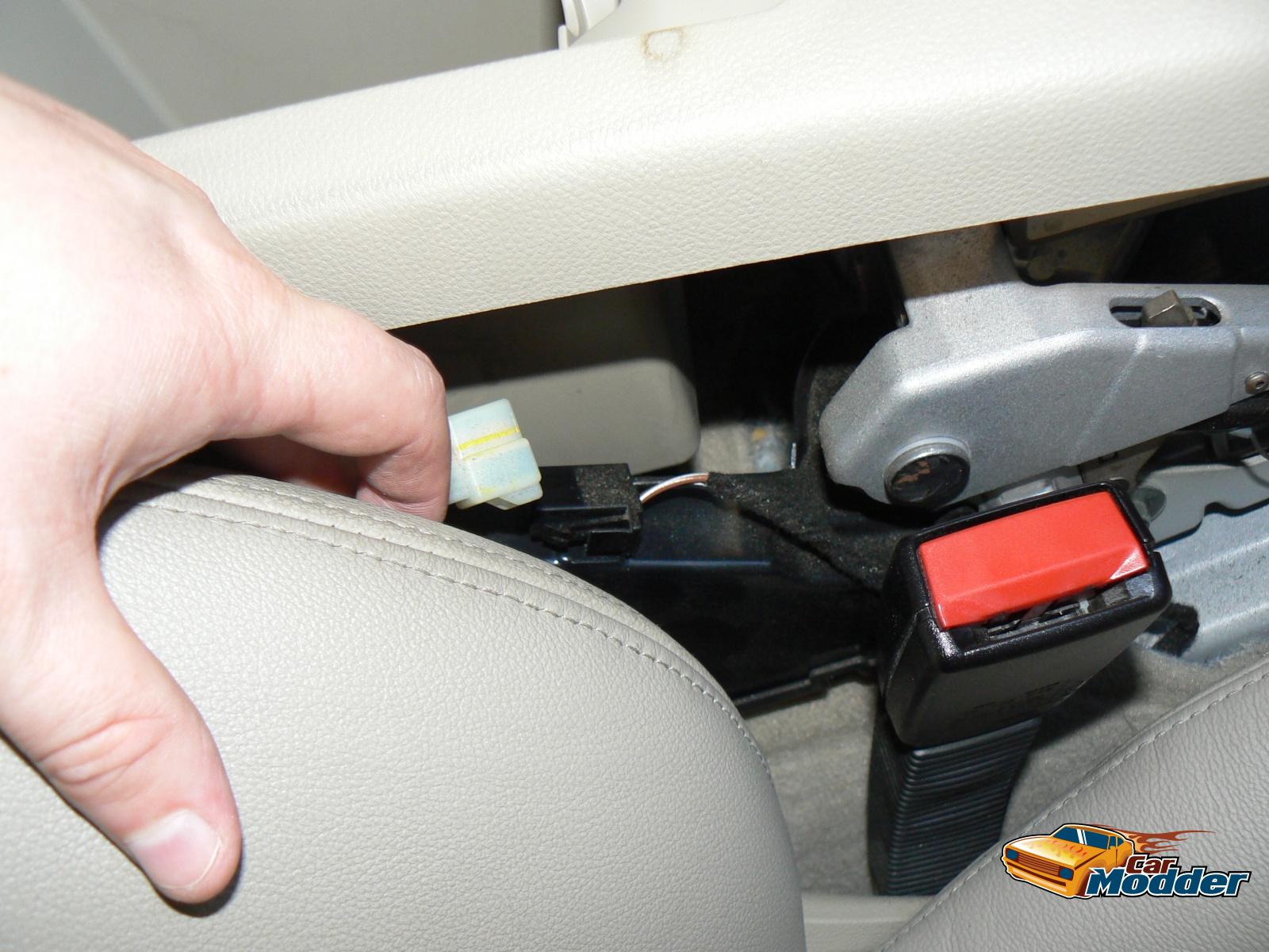

Postby ZerOne » Tue Mar 05, 2013 1:11 pm

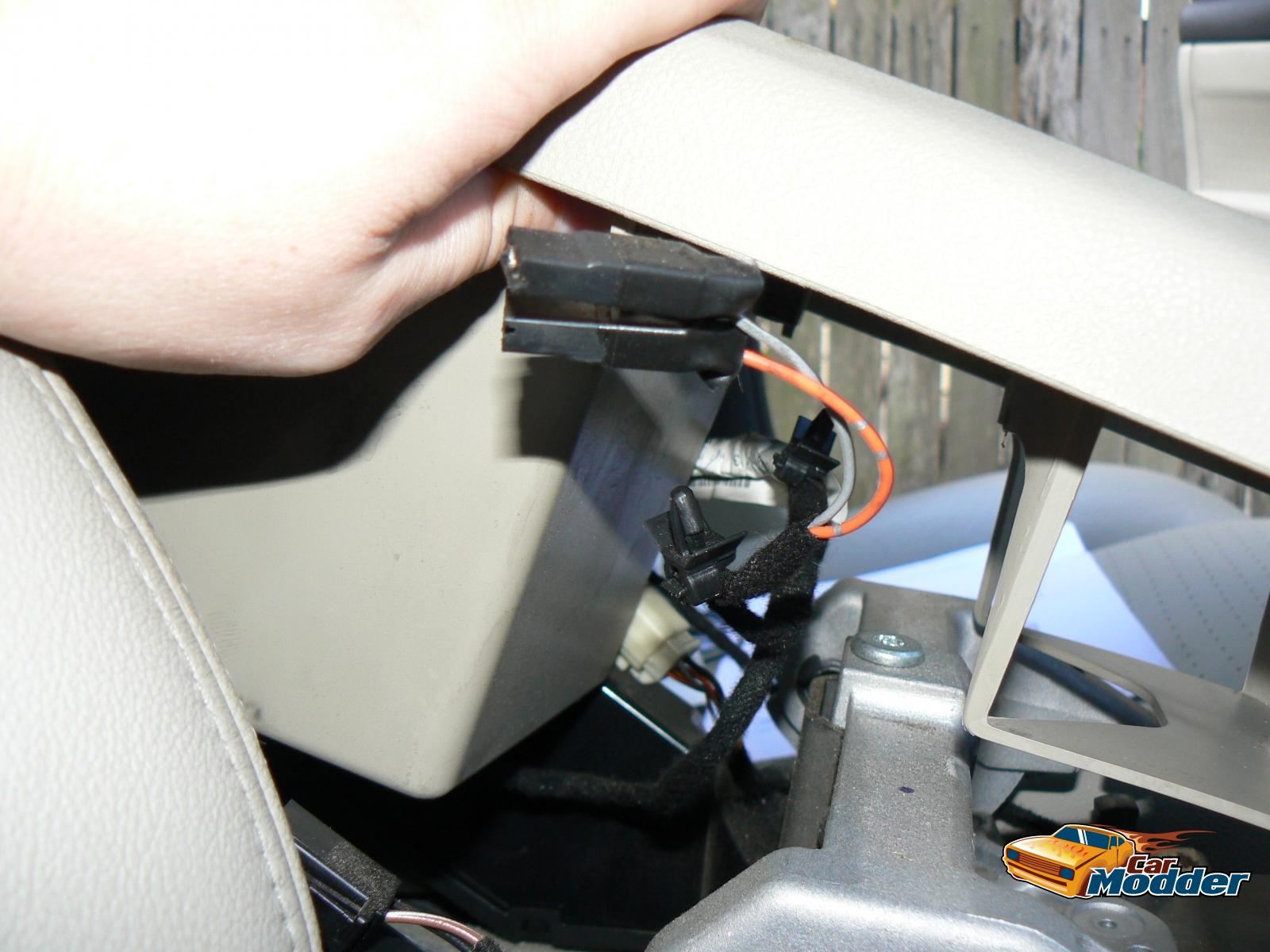

Ill post up as many pictures as possible, to try and help out.

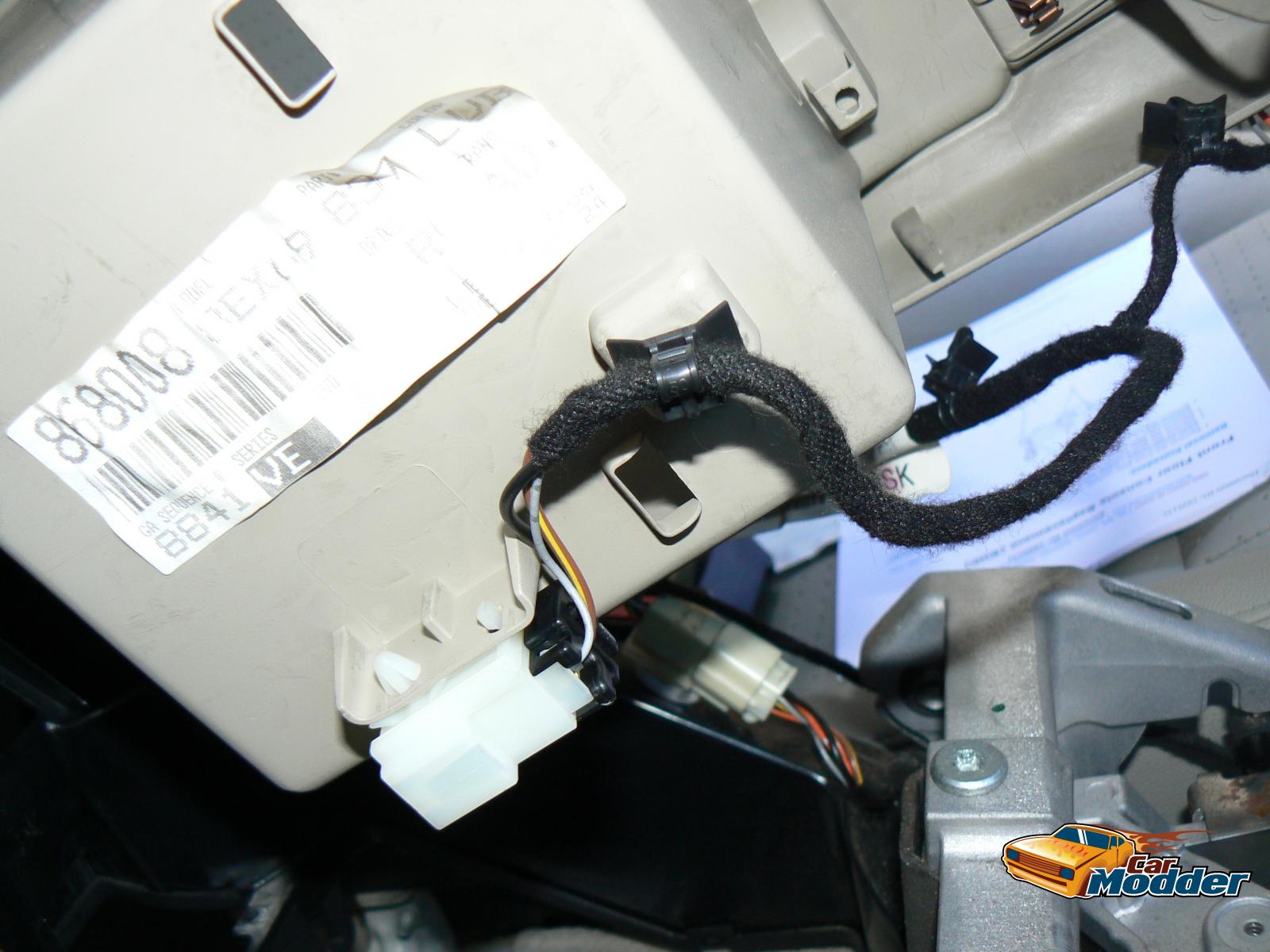

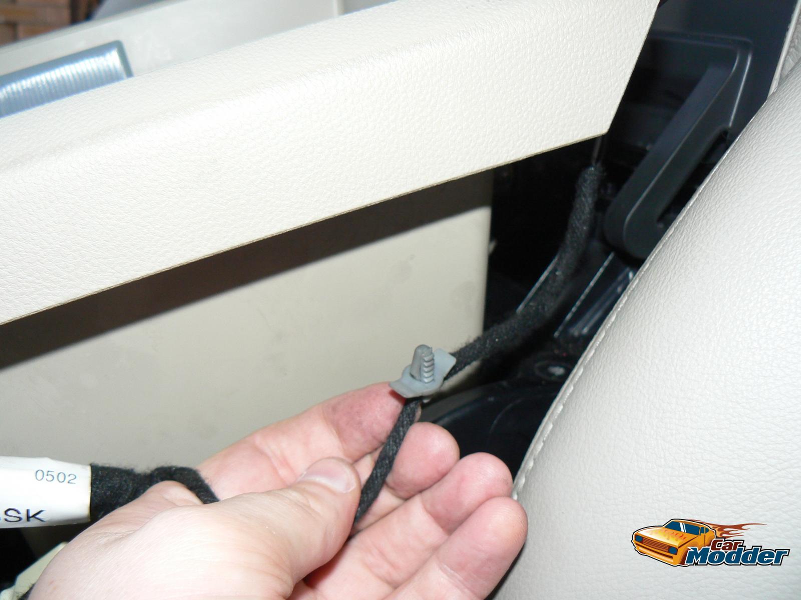

Wires clipping underneath console.
16056 16055
16053 16052

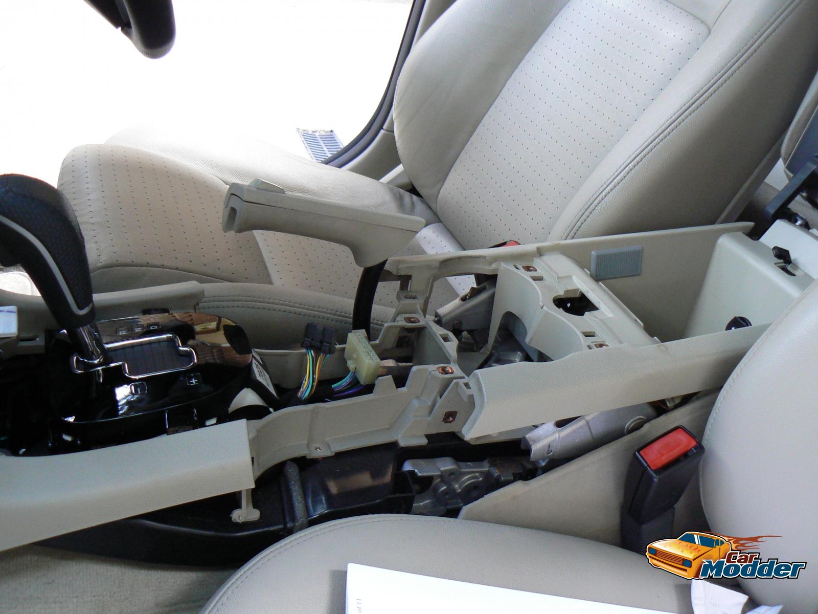

If you want the whole center console bin out, its not too difficult to do, but it will take you around 15 to 30 minutes to complete.

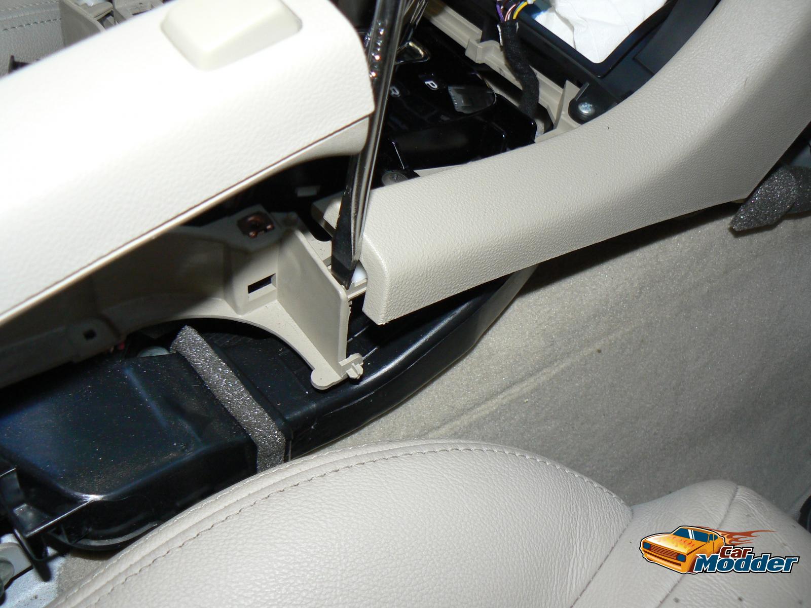

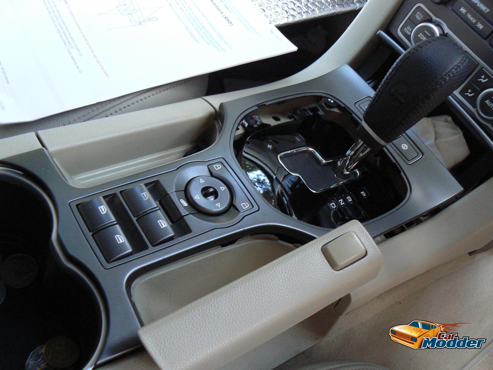

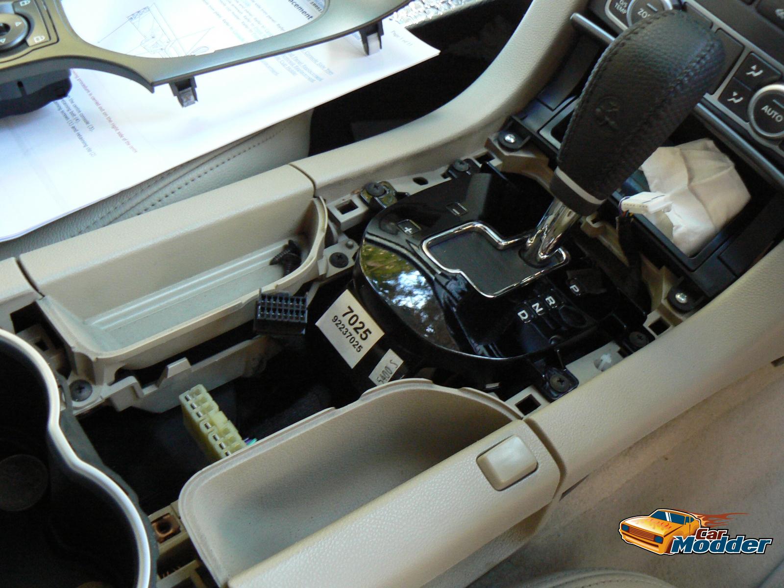

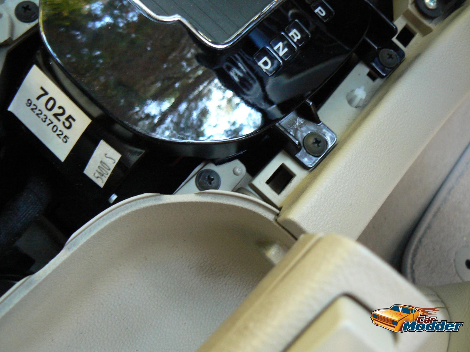

1) Remove the Transmission trim. (To get access to the grab handle and handbrake cup trim bits)
16030 16031

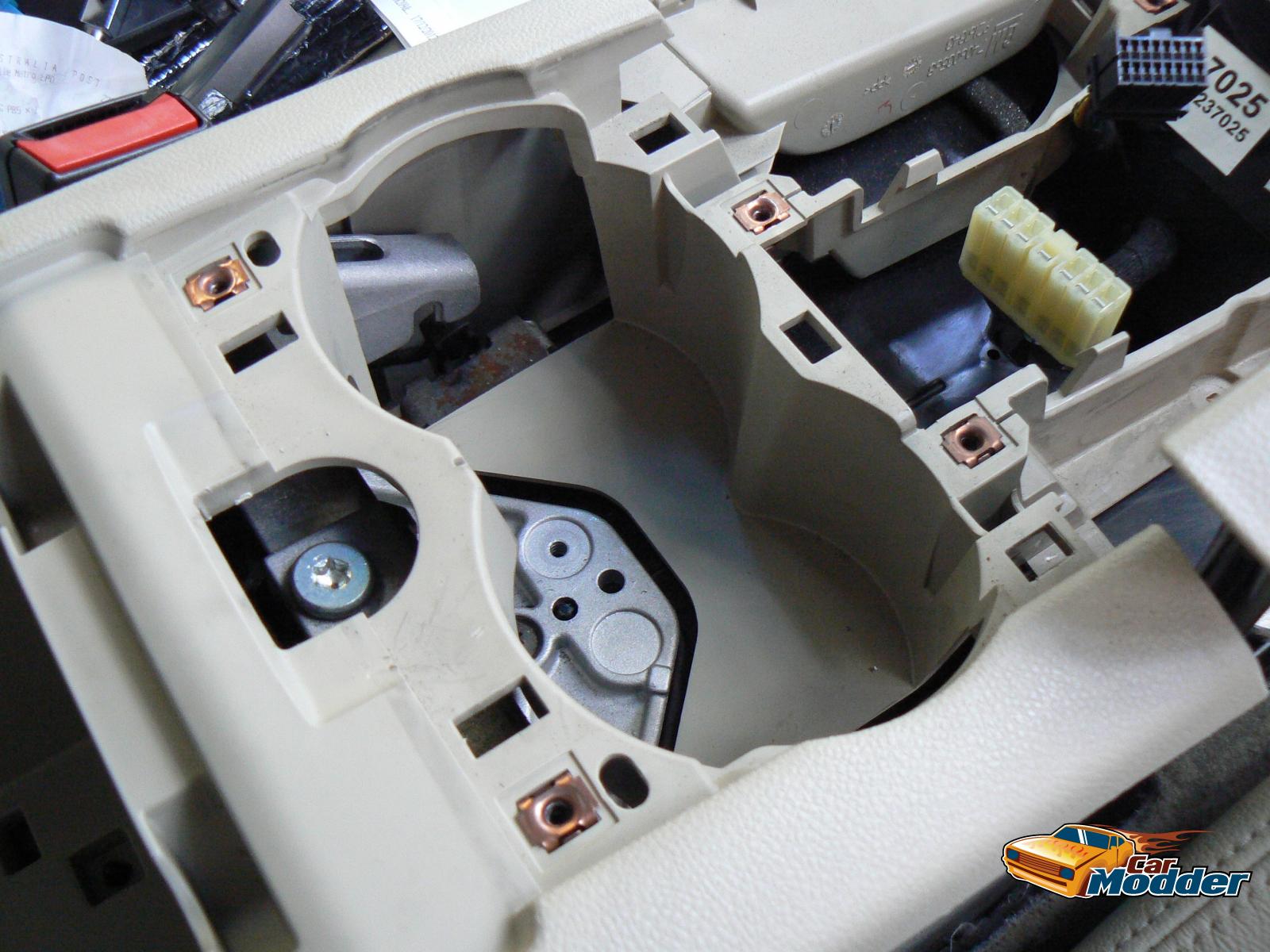

2) Remove the small trim bit behind the cup holders.
16037

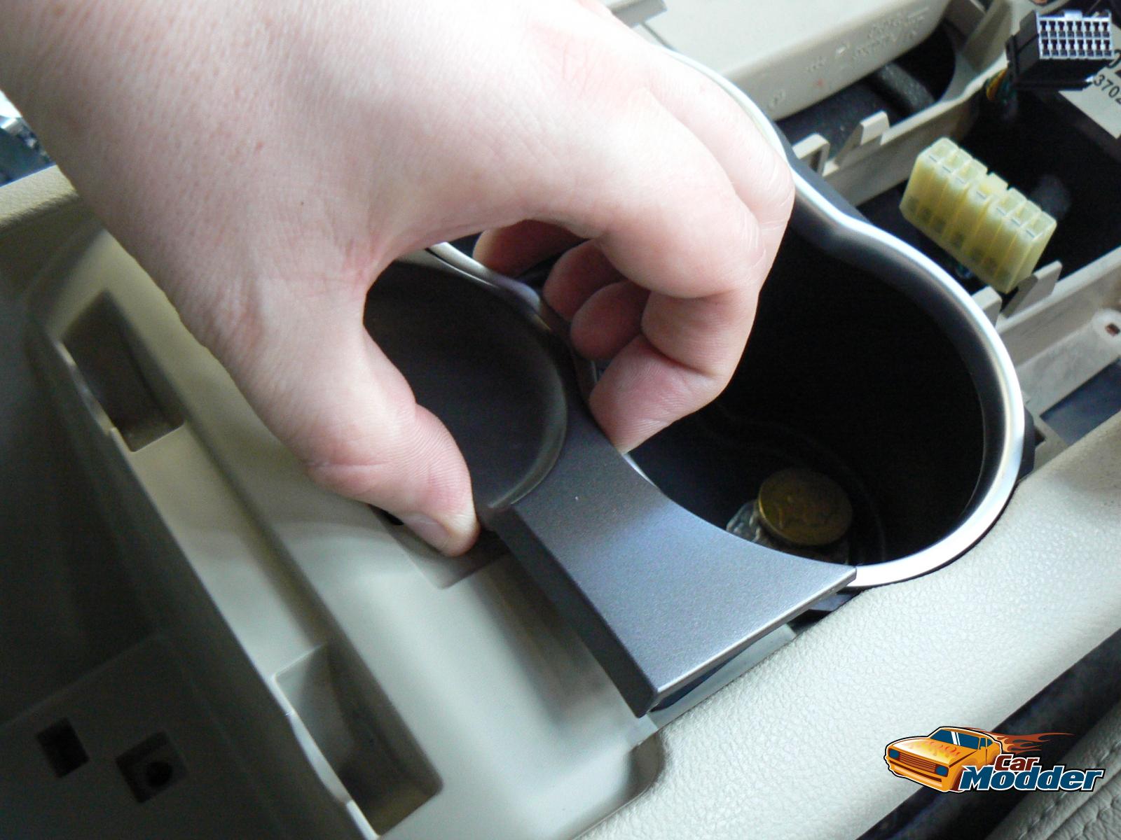

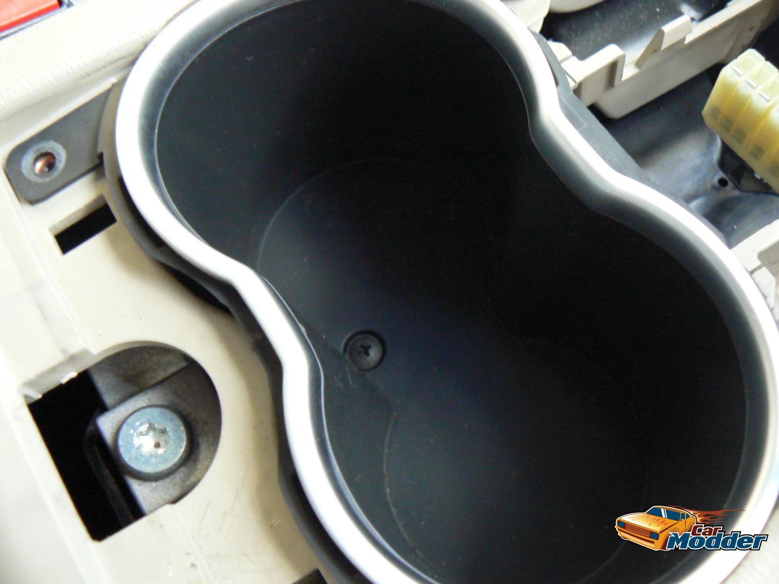

3) Remove the three screws for the cup holders.
16040
4) Remove the Cup holder (It just clips in after the three screws are removed)
16042

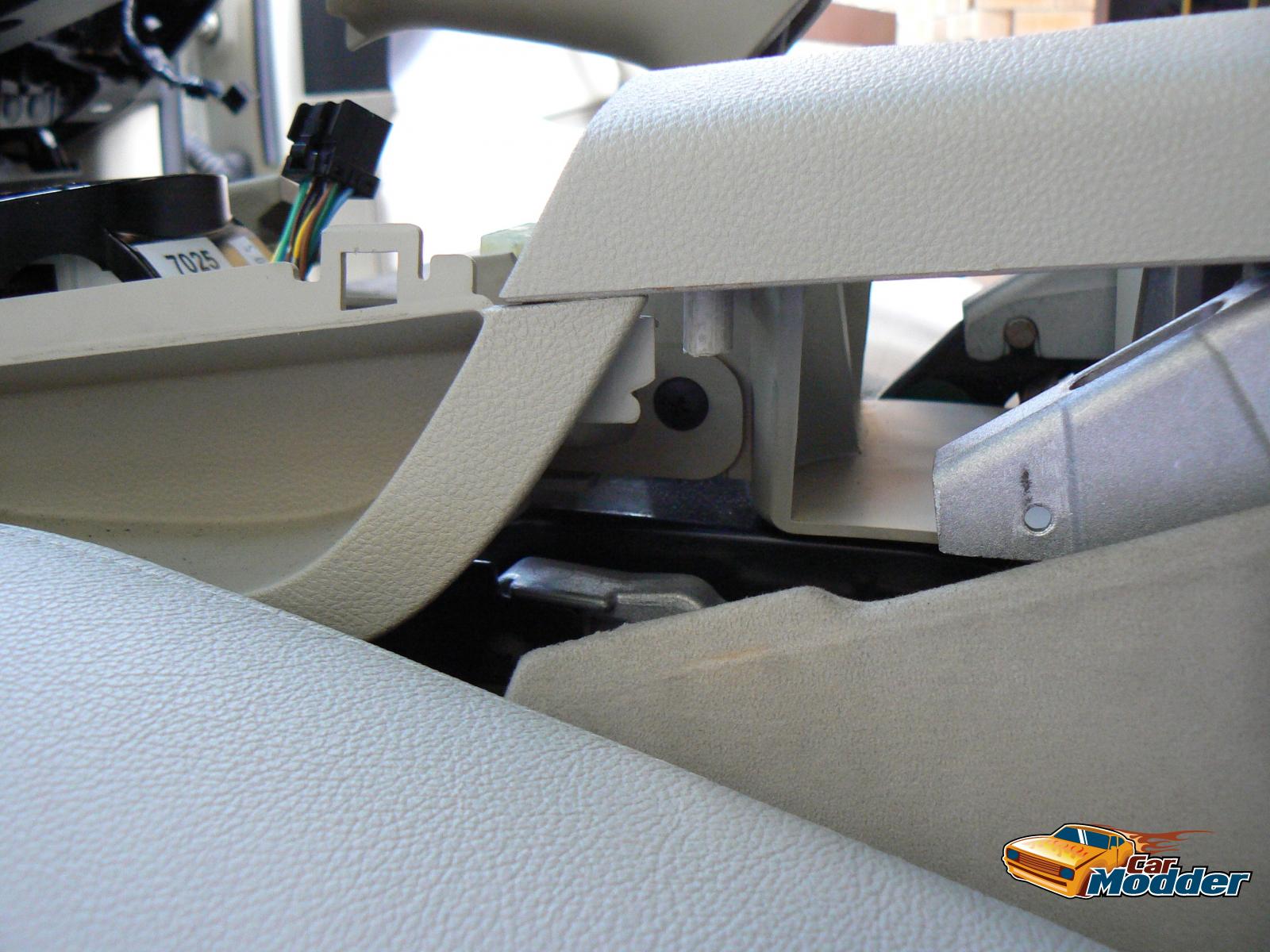

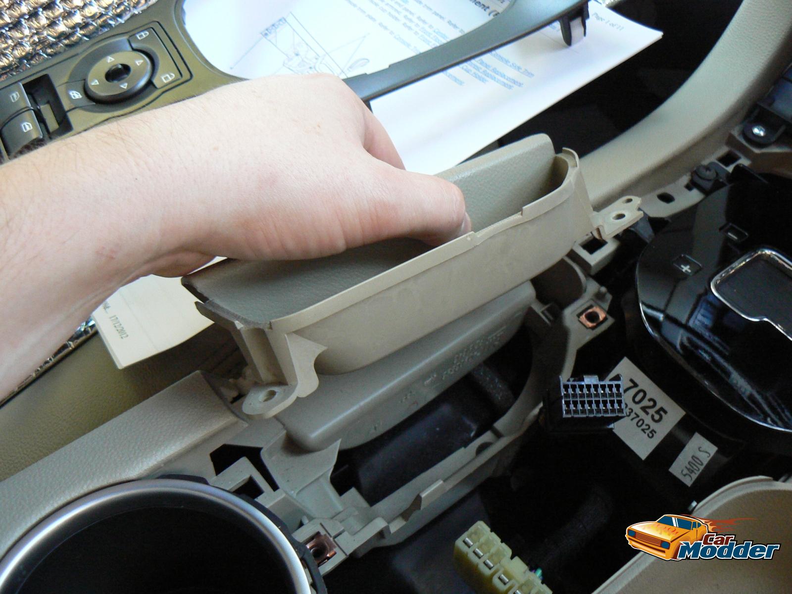

5) Remove the Handbrake cup trim. (I think its held in with two screws).
16032 16036
6) Remove the Upper grab handle trim. (Held in by two screws and clips in).
16034 16035
7) Remove the lower grab handle trim bit. (Held in by three screws)
16043 16044 16945

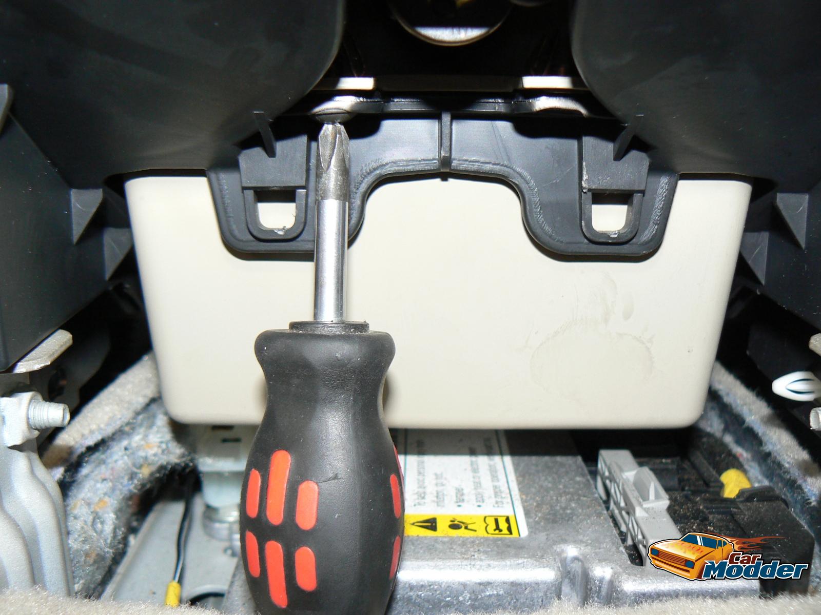

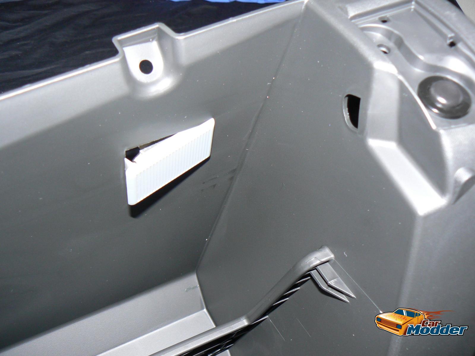

8) Next, remove the 1 screw inside the centre console bin. (You may need to remove the rubber mat to see it.
16028
9) Also don't forget to unscrew these 2 screws at the back of the centre console.
16049 16047

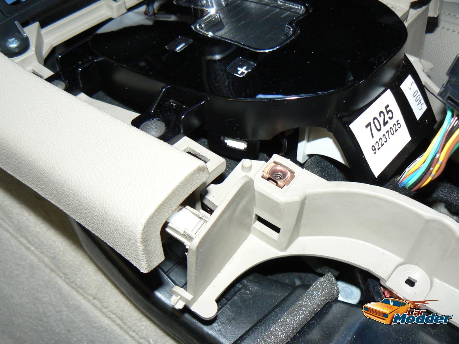

With all this stuff removed, the back of the centre console should be able to lift out,
how ever to get the whole assembly out, you will need to dis-engage the clips holding the assembly to the lower radio trim.
16051 16050 16046
I hope this helps.

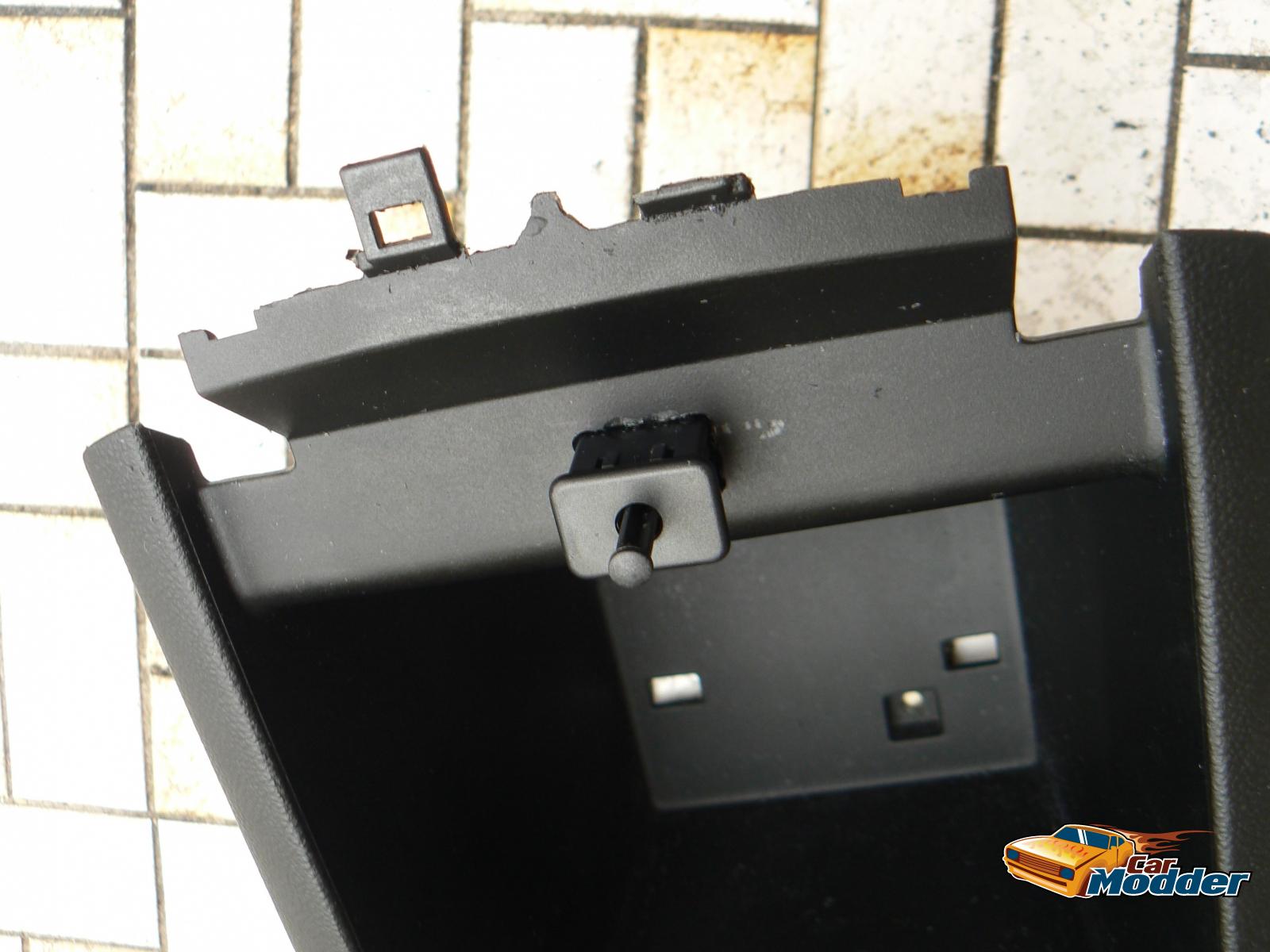

Postby ZerOne » Tue Mar 05, 2013 1:18 pm

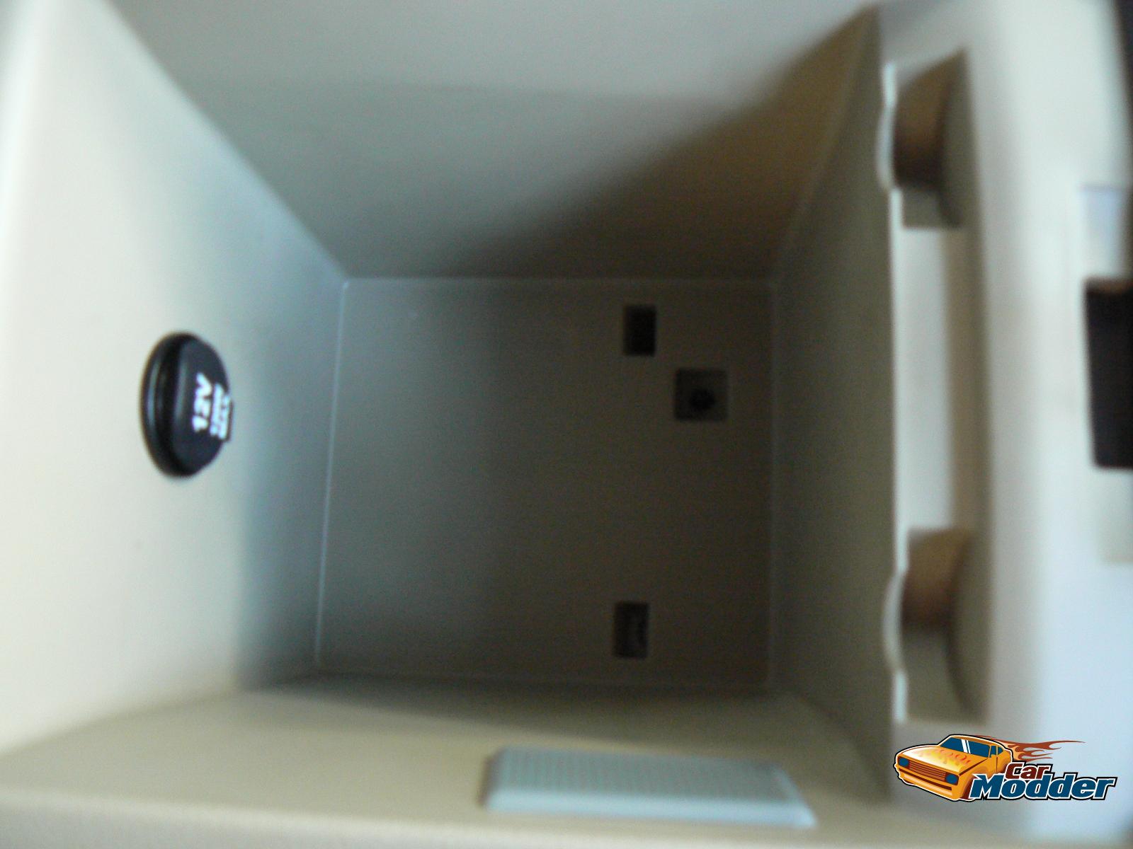

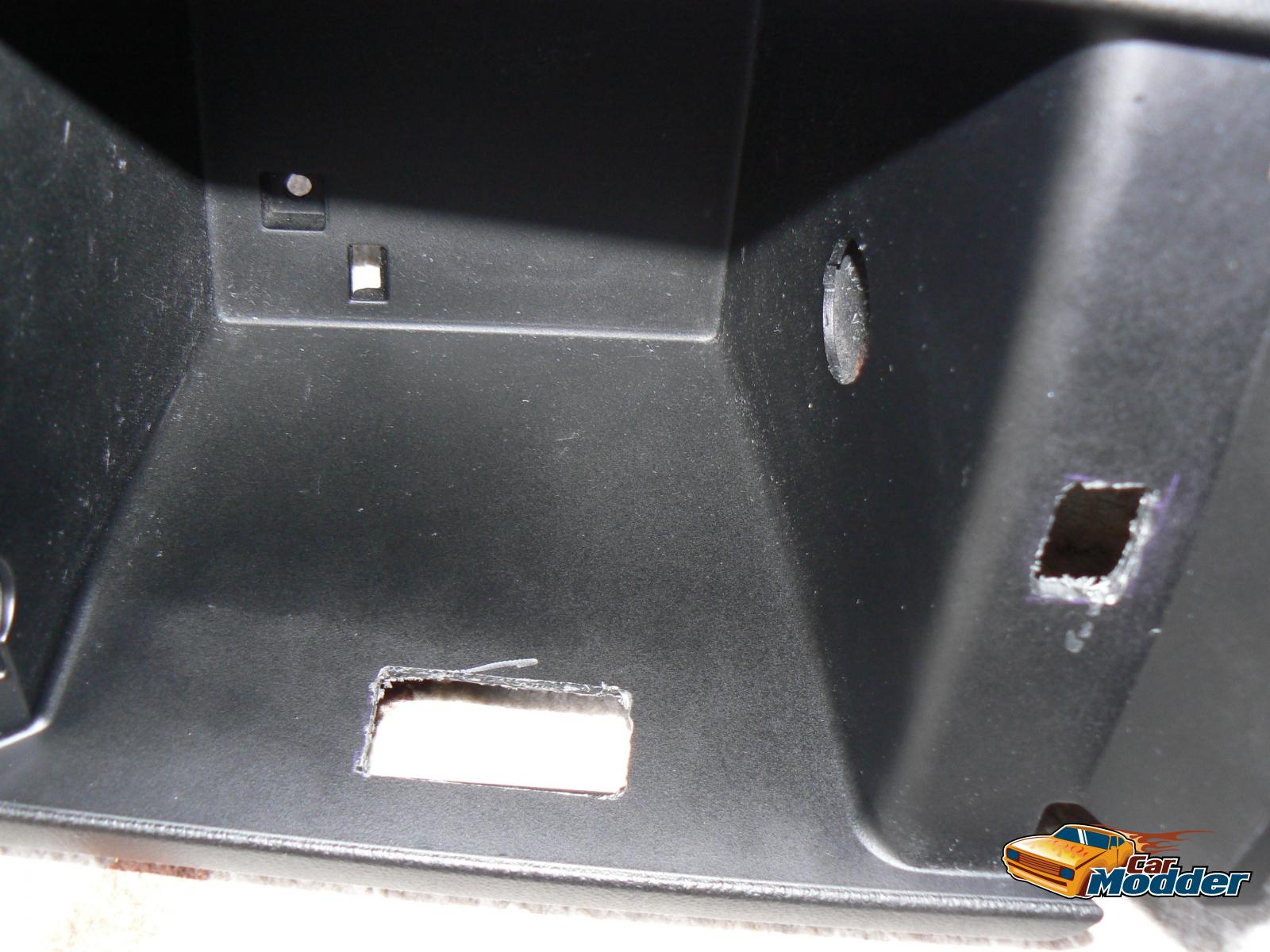

Also if you are going that far, you may want to look at fitting a centre console bin light.
You will need a dremel, and some steady hands (Which I didnt have on this day :(
You will also need a glove box switch and lamp.
16001 16234
16007 16002
