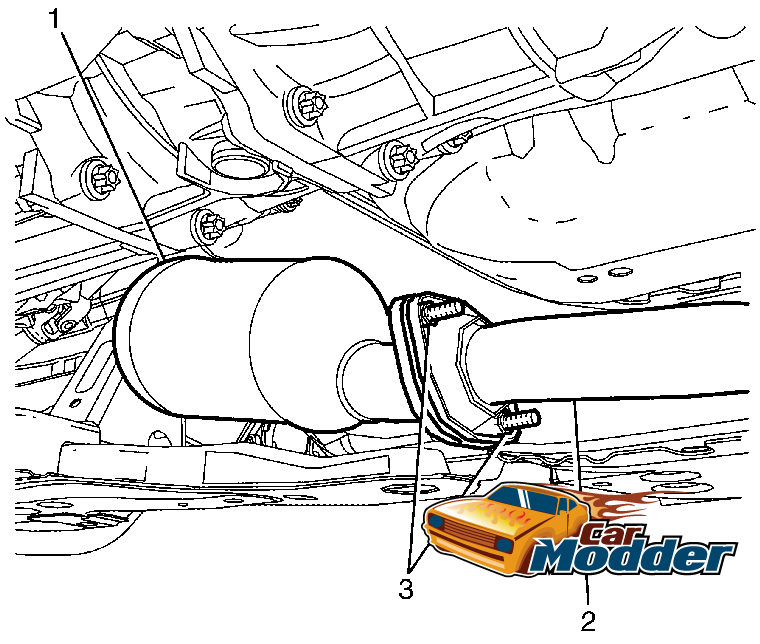

Important: The intermediate exhaust assembly to left catalytic converter retaining nuts (3) are single use parts. They must be discarded after removal.
•Remove the intermediate exhaust assembly to left catalytic converter retaining nuts (3).
Discard the nuts.
•Disconnect the intermediate exhaust assembly (2) from the left catalytic converter (1).
14613
Important: The intermediate exhaust assembly to right catalytic converter retaining nuts (3) are single use parts. They must be discarded after removal.
•Remove the intermediate exhaust assembly to right catalytic converter retaining nuts (3).
Discard the nuts.
•Disconnect the intermediate exhaust assembly (2) from the right catalytic converter (1).
