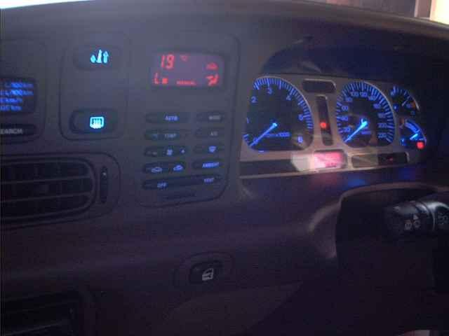

I tried painting the cluster plastics on my old Falcon silver before.
Very hard to get it right, as it showed every imperfection on the plastic,
so I had to use spray putty and sand back a number of times to get it right.
1604
This was done around 10 years ago. I changed the bulbs to Blue LEDs, and it kinda suited the car back then.
