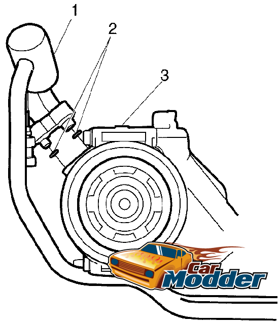

Important: The sealing washers (2) are a single use item and must be discarded after use.
•Remove the sealing washers (2). Refer to Air Conditioning System Seal Replacement.
Discard the sealing washers
Important: Cover any opening of the A/C system with a suitable cap or tape immediately, to prevent absorption of moisture from the atmosphere.

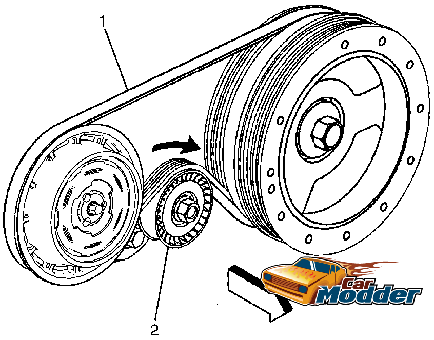

•Using a suitable tool, rotate the air conditioner (A/C) belt tensioner (2) clockwise.
•Remove the A/C belt (1).
•Slowly release the A/C belt tensioner (2).
•Clean and inspect the belt surfaces of all the pulleys.

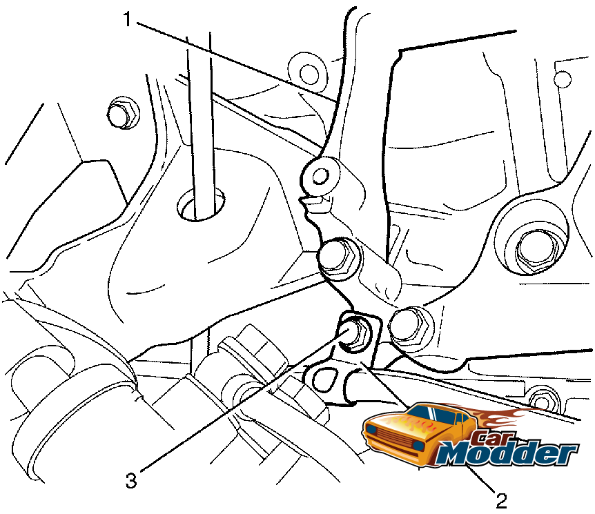

•Remove the automatic transmission cooler pipe clamp to A/C bracket retaining bolt (3) if fitted.
•Position the automatic transmission cooler pipe retaining bracket (2) if fitted, away from the compressor mounting bracket (1).
